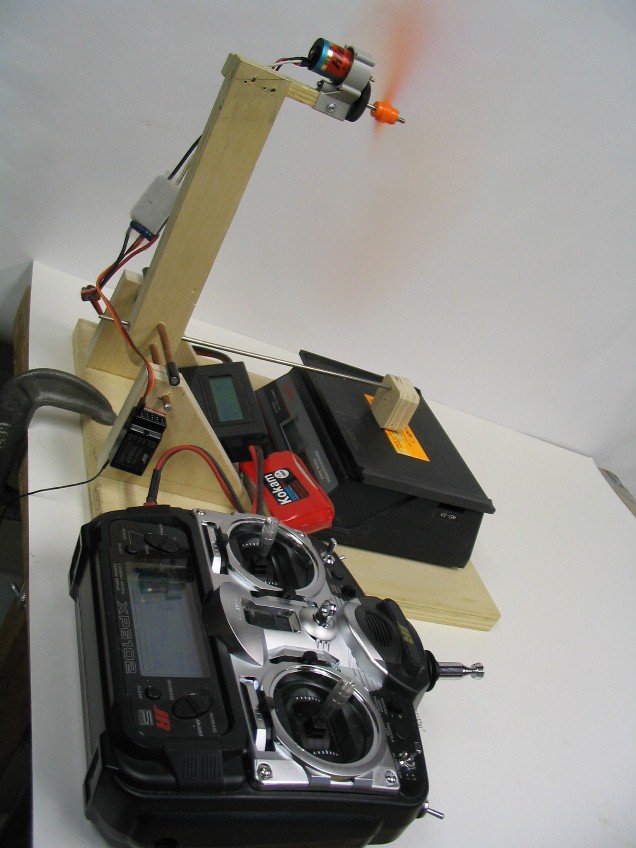

I made a thrust test setup for smal electrics -which provides info very usuable for 3D electrics - it does not do much for the flat out speed enthusiast tho - that type flying requires lots of fine tuning in both arframe and powerplant - been there - done it .
