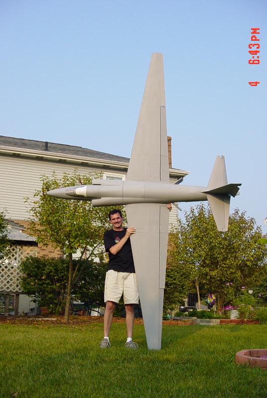

LouW,
I've been building a 1/6 scale turbine U-2A for the past 3 years. I've had some concerns about the aerodynamics of the high aspect ratio wing. With a wingspan of 160", root cord of 23" and tip cord of 6", I worry about tip stall. With advice from another modeler/engineer I've come up with this: A turbulator strip(3 layers of trim striping tape,1/8" wide) about 5% aft of the leading edge on top on the outer 1/4 panel. The ailerons are 30" long so I'll probably cover this area. Your comments, recommendations? Jack
Here's the wing sections:

Vortex, the ribs shown in your first pic with the increase % thickness, added camber, forward high point and washout as shown will most likely be all you need to avoid the tip stall problem. Whoever made the decisions on shape and angles looks like they did their homework and has incorporated every trick I've ever seen for delaying the stall at the wingtips. Save the turbulators for later if you need a slight boost but I suspect you'll be fine with it as is.
If you have not thought about it yet I would suggest a large degree of differential aileron action in the throws and coupling in the rudder to the ailerons to further assist with reducing any adverse yaw. Also you can take a page from aileron glider fliers and ensure you keep the glide speed up a little during the approach pattern. Only once you are commited to the flare should you approach the stall speed just prior to touch down. The adverse yaw has the most effect on tip stalling when the airflow is close to the stalling point and only a little more is needed to force it to break away. I see that you are using flaps on this magnificient model so slowing down during the final approach won't be a problem.
Also train yourself to use smaller aileron deflections when flying slowly and closer to the stall point. Just breath on the stick and give the model time to slowly roll into and out of the turns. No "Bank and Yank" at those speeds or even close. That's another glider pilot trick to avoiding tip stalls.
In fact with 3 years invested you may want to look into building a small scale hack ship that is prop powered just for fun. A simple box fuselage with block tops to give you a "stand back and squint" semi scale look to the model and a similar planform wing and airfoils. 60 to 72 inch span and powered by a 25 to 40 depending on the span and it'll teach you all you need to know about how the wing and the airfoils will perform on the big one. For my part I'd recomend the 72 inch span with the 25 and load it up to a "scale" wingloading to compare to your model. Each wing area size range of model has it's preffered wing loading from light and floaty to heavy and tank like. Figure out where you big U2 fits within that wing area range and reflect that into the 6 footer so it tests the wing properley. Such a lightly powered model would ensure you are investigating the WING'S performance and train YOU at the same time in all the aspects of flying your big one rather than just scooting around with far more airspeed than you need.
While you're at it try it out with some motor assisted thermal soaring. Learning to hold the model at it's happy speed while cruising and in turns that range from shallow to tipped up is a requirement for glider fliers that want to be succesful and it would be a good skill to pick up for you and your U2 I suspect. The emphasis here being on smooth entries using small and smooth control inputs and coordinating the elevator input to hold the model's airspeed even.
If you've read much on the flying of the full sized U2 at altitude, as I'm sure you must have, you'll realize that this is how the pilot's fly the real ones during the missions. That bit about the ceiling being limited by the stall speed rising and the mach speed falling to the point where they are dealing with a 5 to 10 mph envelope floored me. The description about how to deal with turbulence in the turns (is the inside wing stalling or the outside wing hitting compressability?) was fascinating and reflects the smooth and gentle inputs I'm suggesting here. You can still tip it up for sharp turns but the idea is to slowly roll and recover from the high bank angles while controlling the elevator to avoid any stalls or dives. Done well it'll look like one of those graceful aerobatic sailplane airshow routines.
And of COURSE you'll be fitting cameras into BOTH versions....

Bruce,
First of all, thank you for taking the time to reply to my concerns on the large scale U-2.
With the approach of the systems testing and radio programming for this complex airplane, I appreciate your input. Large differential aileron and rudder to aileron coupling will be incorporated. The idea of the smaller version powered glider was thought about some time ago. The closer I get to the first flight the more likely I am to to practice with something not so critical. I need to be sure I'm not in the bank and yank mode since I fly the short-wing turbines. I had an 80" ducted fan U-2 but it flew much too fast. It's demise was met while in a turn, unable to roll out.
For additional roll control and to counter aerodynamic dampening, the flaps will be mixed with the ailerons to a max or 5^ up. I prefer to mix only the outboard flap but this gets too complicated with the radio. There should be plenty of drag as the large speed brakes extend >45^.
I was told that the Reynolds Numbers that this model operates at, is much like the real one was at altitude. Not Sure.
Yes, I have done extensive reading on the U-2 and retain a copy of the Air Force -1 (flight manual) of the early one. There were many flying lessons written in the manuals in those days. Perhaps because of the many losses.
I have the onboard camera standing by as well as an anxious 1/6 scale test pilot!! First flight in '05
Jack

The tiny speed envelope at max altitude -is not peculiar to the U2-
Check with any guys who drive commercial jet stuff.
the window can get pretty tight.
(I know this is not a model thing -just commenting )
as far as fretting over the airfoil - -just make it as equal as possible from wing panel to wing panel.
On this type planform (aircraft as viewed from above)--the real evil doer will be the DIFFERENCE in airspeed between wing tips.
One of my first experiences in RC modeling -35 years ago - was a model laid out in a very similar setup -- close coupled - small stab.
It was extremely easy to yaw the model at low / landing speeds -OR in a slight crosswind - trying to visually level the model-- get a difference in tip speeds .
the result was always a drop of the slower panel- and correction was always impossible .
The lateral area on the U2 makes yaw control touchy -- we do this on some models to make them good in wild aerobatics - but in this setup - I would sure make sure I had the landings and takeoffs well up to speed so that the plane is ON the ground anytime speed is below positive control on all surfaces
