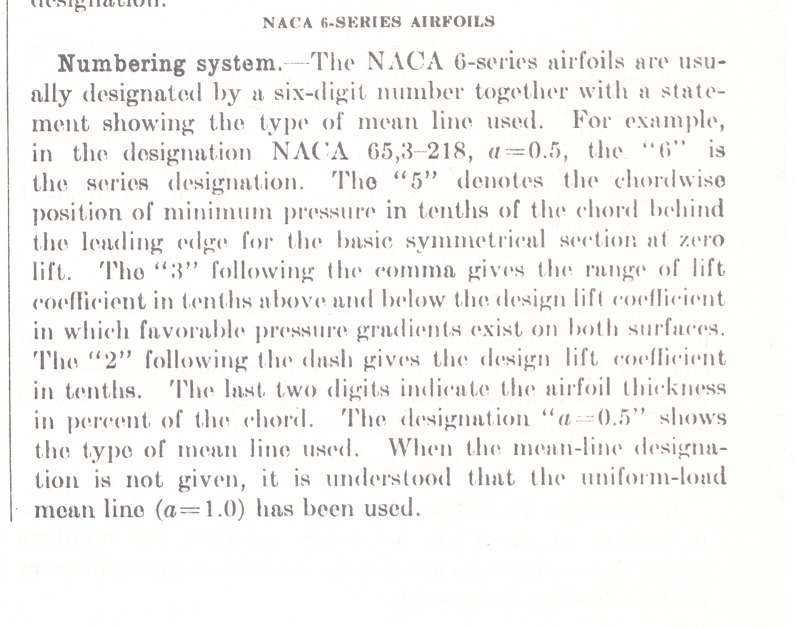

Here are a couple of exerps from the NACA Tech Report #824 "Summary Of Airfoil Data".
The first attachment shows the lift characteristics, shape, and coordinates for the 63-015 and 63-018 airfoils. The second attachment is a partial section of the numbering system for the 6-series airfoil.
WS.....
I copied what you noted and placed into Compufoil then into Autocad. The initial 70% fit right over the drawn lines from the plan. The last 30% was too thin. -Which is normal for models. I had to thicken up the area around the T.E. to fit available balsa wood stock and DuBro hardware items.
Overall it fit better than the 65A which had been generated via a library file.
