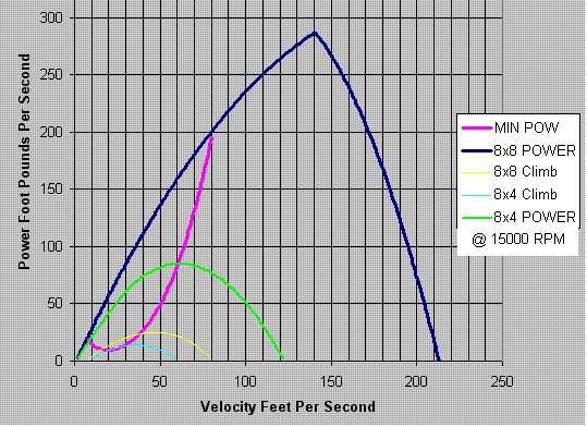

I just want to agree with most of what has been said. Yes there is a point that extra rpm really doesn't get you much. Both have been talked about. One, the prop tip speed. I try to keep mine down around mach .5 for the noise and safety reasons. Remeber if it is loud it is draggy. As was stated before around mach .8 you really start to pay a big price in terms of power for any additional thrust. Two, the plane/prop relationship.
The first issue is pretty easy to address, how much do you value your safety and ears. Since your limited to an 8 inch prop, this is 2/3 of a foot and the curcumfrence would be 2/3*pi or 2/3*3.14 or a little over 2 feet. The speed of sound is about 1100 fps. So if we want to keep it below mach .8 we have 880/2 or 440 rps or 26400 rpm. Say we didn't want to push it quit this high so we limited our prop to mach .6....660/2=330 rps or almost 20000 rpm.
I've attached two graphs, both using 8 inch diameter, 3.5 pound wieght plane with a wing area of 5.5sqft (the wing area wasn't stated). I also assumed a somewhat draggy airframe, gliders have a lot of frontal area and surface area.
The first graph is of an 8x4 and 8x8 both at 15000 rpm. By my calculations the 8x8 would produce around 50oz thrust static and the 8x4 would produce about 38oz of thrust static at 15000. The big story is that the 8x8 prop would require something around 620 Watts of input power and the 8x4 would only require 220 Watts. The 8x8 would have a max climb rate of about 25 fps and the 8x4 about 12 fps. Notice you will never reach the speed needed for max power output for the 8x8 but with the 8x4 you will. Your top speed would be about 80fps (56mph) for the 8x8 and 60fps (42mph) for the 8x4.
The second graph is of and 8x4 at 20000 rpm and the 8x8 still at 15000. The 8x4 at 20000 rpm would need about the same input power as an 8x8 at 15,000 but the 8x4 would produce about 64 oz of static thrust. The max climbrate for the 8x4 is 35fps and again the top speed is the same for both props..80fps.
Now any relationship to actual reality is only an accident, and I don't fly electric so draw your own conclusion just thought a graph might clear up what everyone is talking about.
Power in the graph must be above the min power line (pink), this line is the minimum power for level flight. Climb is substainable climb.

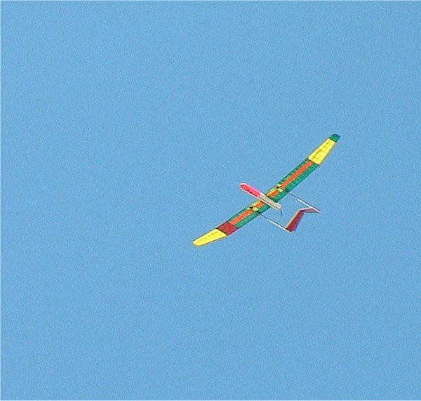

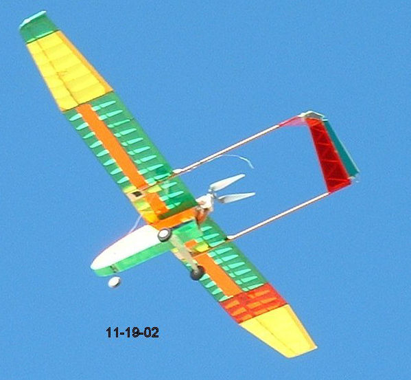

Brushless is the only way I go any more. From what readings I can get with my handheld mini tach, I believe I am getting close to 15,000 rpms. I have flown the plane once and had trouble with the throttle settings causing it to try to over throttle causing over amps and heat shutting down the ESC. I now have that solved and am planning another flight as soon as weather permits.
This is an Aero-naut Aerofly. Discontinued kit that I built for a friend. It's over all weight is 3 pounds 4 ounces with 102 inch wing span. The maiden flight was short but, had plenty of power for the plane and would have climbed easily if I hadn't had the cutout problem. I used new Align brushless s400 size that could handle 25 amps and I used two, three cell Kokam 1500 11.1v Li-Po's in parallel.

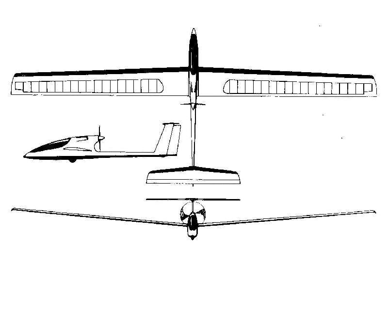

Tall Paul, if you had read my post just before yours you would see that the prop does push the plane quit well.
Since no one would believe me, I finally got the 3-d view into the scanner and copied it for all of you. Here it is.

I FLEW THE PLANE JUST FINE AND I HAVE THE VIDEO TO PROVE IT!
THANK YOU VERY MUCH. And, a folding prop WILL NOT WORK!!!!!!!!!!!!!!!!!!!!!!!!!!!.
Did you see the drawing I uploaded?

ORIGINAL: agcatsbest
Now. I had heard in several places statements like "you need a gear setup with a larger prop because if you just keep speeding the prop you reach a point where it's just beating the air and adding nothing.
.If you hold a plane on the ground and run your 8x6 prop at 15,000 rpm then the prop blades are stalled and in that case you might say that you are "just beating the air". If you release the plane and let it speed up the portion of the blade that is stalled gets smaller as the velocity picks up. At about 25 mph your prop is not stalled. So whether it is "just beating the air" depends on the velocity also. I still think you would be better off with an 8x4 or 8x5 prop, which will not be stalled on the ground. You will get a lot better pull in the 0 to 25 mph range and I doubt if you care about the extra top speed that the 8x6 prop gives you.
Try the freeware program prop selector. [link]http://www.gylesaero.com/freeware/propcalc.shtml[/link] it gives an indication of when a prop is stalled and how badly it is stalled.
This site has good diagrams showing props and velocity vectors and a little on why they stall
[link]http://www.auf.asn.au/groundschool/propeller.html[/link]
I do note that you had 3 estimates for motor power, 200 W min, 320 W max and a fairly careful calculation stating
