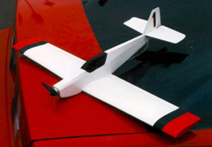

Dick, yes, I do fly 100 sqin models for sport use. I don't fly flat plate foamies, however.
The gentleman did not say what type of model this was to be... he only asked if the wingloading was unreasonably high.
I can say from extensive personal experience that the wingloading of 14oz/ft2 is completely and totally reasonable and the model should fly quite nicely, provided it has reasonable power. It will probably not be a great 3D aerobat, but it will be fine for pattern style aerobatics and general sport flying.
I currently fly a 75 sqin pylon racer with a wingloading of 23 oz/sqft, a 96 sqin pylon racer at 18 oz/sqft and several 100-130 sqin sport/scale models (warbirds) at ~14 oz/sqft. All of these models are quite safe and fly very well, provided you have realistic expectations and decent piloting skills.
-David
-David

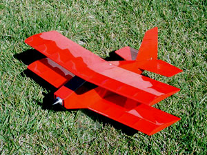

csisfun,
You're probably making a good decision to go with a biplane if you are not experienced with "heavy" models. Lighter planes takeoff and land more slowly, and are generally easier to fly. Lowering the wingloading by adding a second wing is a good way to go. I'm including a couple pictures of small airplanes I designed and built to give you a little encouragement. The biplane has a 23" wingspan and weighs about 13 ounces. The low-wing sport plane has a 32 inch wingspan and weighs about 12 ounces. Both fly very nicely.

Those are beautiful planes. I'd love to see them fly. Is that monokote you used?
One problem with Bipes that I'm having is their wing arrangement (difference in incidence between both wings, positioning on the fuselage, struts, flying wires etc.) . I've seen some plans, and all of them are different in their own ways. Currently I am planning to place the top wing further towards the nose than the bottom wing.
Joined: Jun 2003
Posts: 691
From: San Diego, CA
Thank you!
I used the light-weight, low-temperature covering film. There is even lighter stuff available today, but I wanted the covering to be pretty durable. The specific film I used was "Top Flight Econokote."
I avoided all of those decisions about wing placement on the biplane by keeping it simple. The two wings are at the same position along the length of the fuselage, and they have the same incidence angle (everything is basically 0-0). It may not be the "best" setup, but it works. Because the model was so small and the top wing mounts to the fuselage, it also did not need any struts or flying wires. The airfoil is an E-205, but it's not all that accurate because the covering sags between the ribs and spars.
Good luck!
Good luck!
