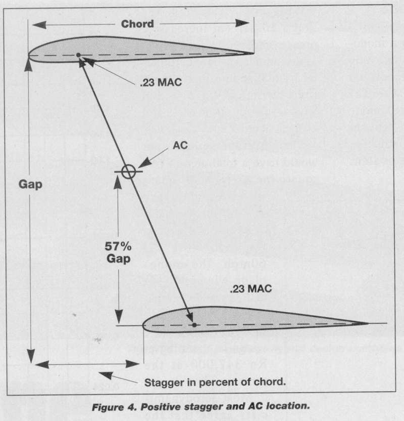

Now I've asked around, and it seems that the CG for a bi-plane is NOT the highest point of the top wing contrary to most monoplane designs. Is there anyway to calculate the CG for flying? Or else where would a starting point be. My scratch built has a positive stagger and same amount of incidence.

This has always worked for me.

Hmm... don't quite get it.
What is this picture trying to say? Sorry, can't make anything out of it. Is "AC" supposed to be CG?

"AC" is "Aerodynamic Center".

An easy way to pick a starting point (if the wings are of the same size) is to look at the projection of the surfaces looking straight down from above and set the CG at 25 % of the projected area. With positive stager this would be 25 % of horizontal component of the distance from the leading edge of the upper wing to the trailing edge of the lower wing measured from the leading edge of the upper wing.

AC does equal CG.
