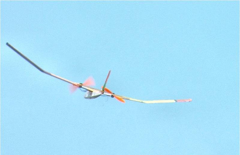

I have been playing with seperate ESCs on a twin, to handle the rare occasion when one motor quits,
both as a pusher and a push-pull...
With this Gentle Lady, the plane is controllable at less than 40% power on one motor.. it will turn into the running motor.
More than that amount of power, it can't do that.
With a wingtip motor running.... I think "Frisbee" is an apt description.
Euuuuuuuuuuuuuuuu!

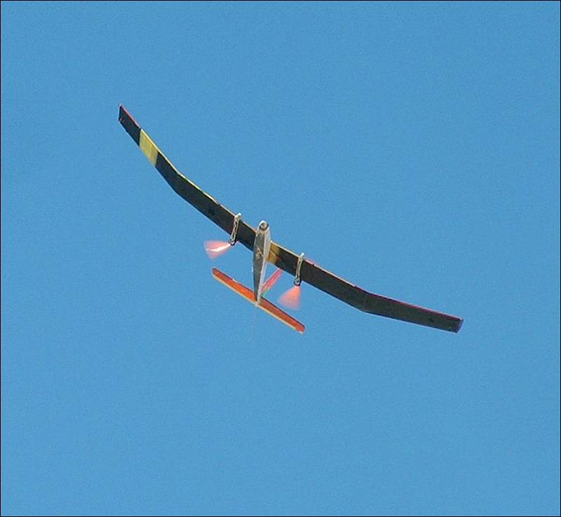

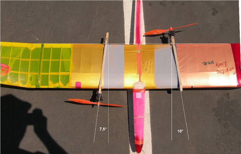

Both motors have seperate speed controls, running from seperate channels.. the left motor on ch. 3, the right on ch. 6.
Using P-MIX-1, 6 is slaved to 3, with the knob on 6 set to sync the motors.
Either or both can be stopped in flight.
The plane runs out of rudder control preventing the running motor from pushing the nose towards the dead motor at about 40% power.
Adding "outthrust" of about 10 degrees to each improves that to about 50% power, before the rudder can't stop the turn.
The conclusion I draw is a power failure, glow or electric with a twin is very deadly, IF the power isn't instantly cut back to idle, and the dead motor identified so the corrective controls can be used after the live motor is slowly advanced in power to get the plane back.
The last photo shows full rudder with the plane going to the right. Pulling back power will let the plane go to the left, straight or right.
