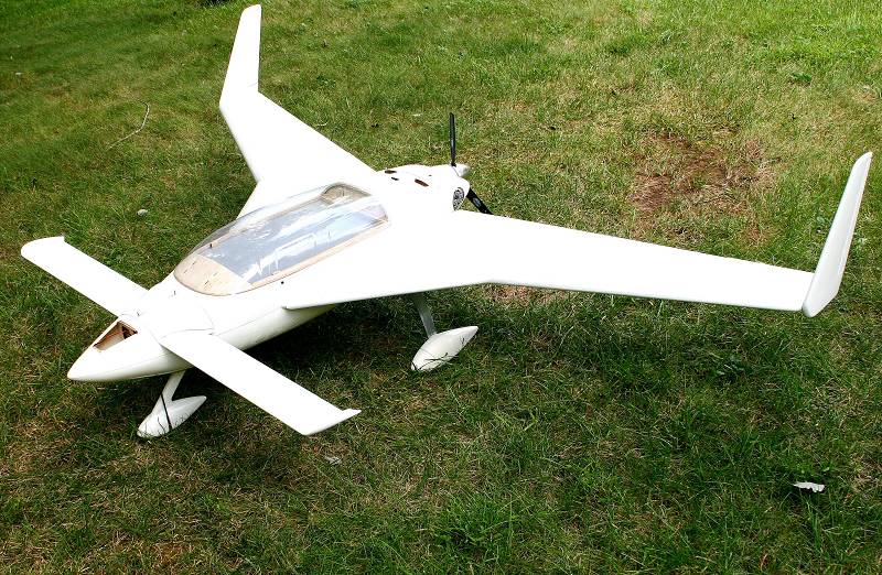

Here's a photo. An all white airframe dosn't photograph well.
80" wingspan, 44" canard span, wood frame wing and canard with UltraCote, fiberglass fuselage
Uses an OS 1.08 with Perry pump, 14-7 pusher 3 blade prop.
Awaiting paint on fuselage (gel coat only for now)
Will be reviewed in R/C REPORT Magazine in a few months.

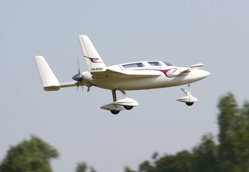

Fly? I was just trying to keep it in the air!
Actually, it does fly very nicely. That canard lifting area must have helped since I overshot 3 landing approaches.
Lots of up elevator needed to get it into the air (nose heaviness) but it flew great. The OS 1.08 pulls it quite nicely. Half throttle for cruise.
I did a few rolls but no loops (probably not enough elevator left)
That's just about all this plane will do. I didn't connect the rudders but stall turns aren't in the book.
It seems to stall straight ahead, and will "porpoise" if up elevator is held.
I took out about half a pound of nose weight (I had added 2 1/2 pounds to get it to balance by the book)
The CG is now rearward about 3/4" and the manufacturer says the starting CG point is very "generous".
