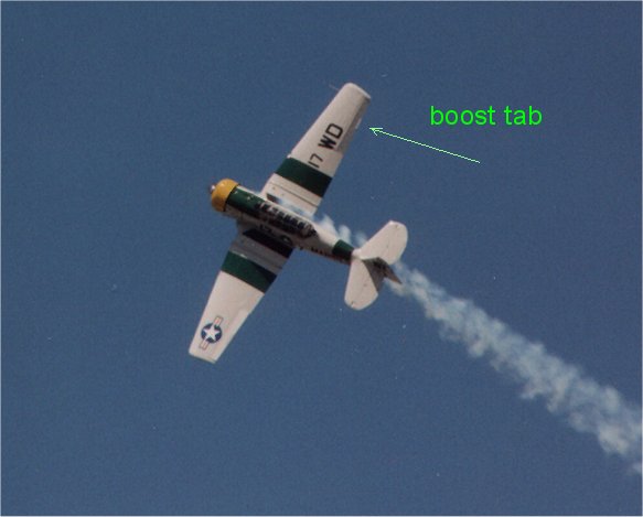

An article way back when in MAN discussed using 'offset' tabs to assist servos on the control surface. In case my technojargon is incorrect, The tab moves opposite of the intended direction of the surface. E.g., if the elevator goes up, the tab goes down. Then there is what is referred to as a 'boost' tab, which would go 'up' further than the 'up' elevator-or down as the case may be. Is either effective, and what factors determine which one is used? Building a Storch which has aileron tabs, but I don't know which type was on the original. Actually made a mock up from pics, but they don't show the whole surface sufficient to tell how it worked. This pic operates like an 'offset' tab, but I don't know which way the full size worked.

The boost tab works this way..
Check out the T-6 aileron.
The L-1011 uses a similar situation on the horizontal... but it works in reverse.
What appears to be a normal elevator is in actuality a geared tab, which moves -more- than the horizontal surface moves and in the same direction, to alter the camber and therefore boost the control authority of the slab.
