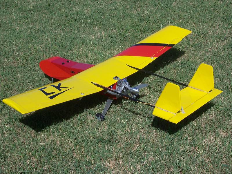

I wonder how fast it would drain a battery though? In anycase, by the time my budget recovers from my last experiment (see picture below) I will definatly have to try this.
I'll probly start out with them as a combination...unless it gets to heavy with the fans and servos.

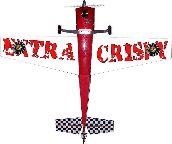

Hey,,, I already got a name for it. Extra Crispy lol !!

Old 10-10-2005 | 03:37 PM
Joined: Sep 2003
Posts: 674
From: de forest, WI
Default RE: New way to control roll?
I didn't think Chickens could fly
Like I said before "This a very scary thread"[:-]
