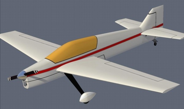

On my upcoming (.90 to 1.20 size) pattern plane, ( http://www.nextcraft.com/j45.html ) I've done what you suggested, and have the stab 1 inch higher than the wing. (image attached)

Great design you have going there. Nice lines. We also found (with center mass mounted wings) that sweeping the Hingeline of the rudder back about 5-7 % made a great difference in knifeedge and point rolls as well.

Thanks GW.
(It's not radical, but it's mine.)
Since this one has plug-in wings, that should be an easy thing to test. I'll definitely keep that in mind if there are coupling issues.
