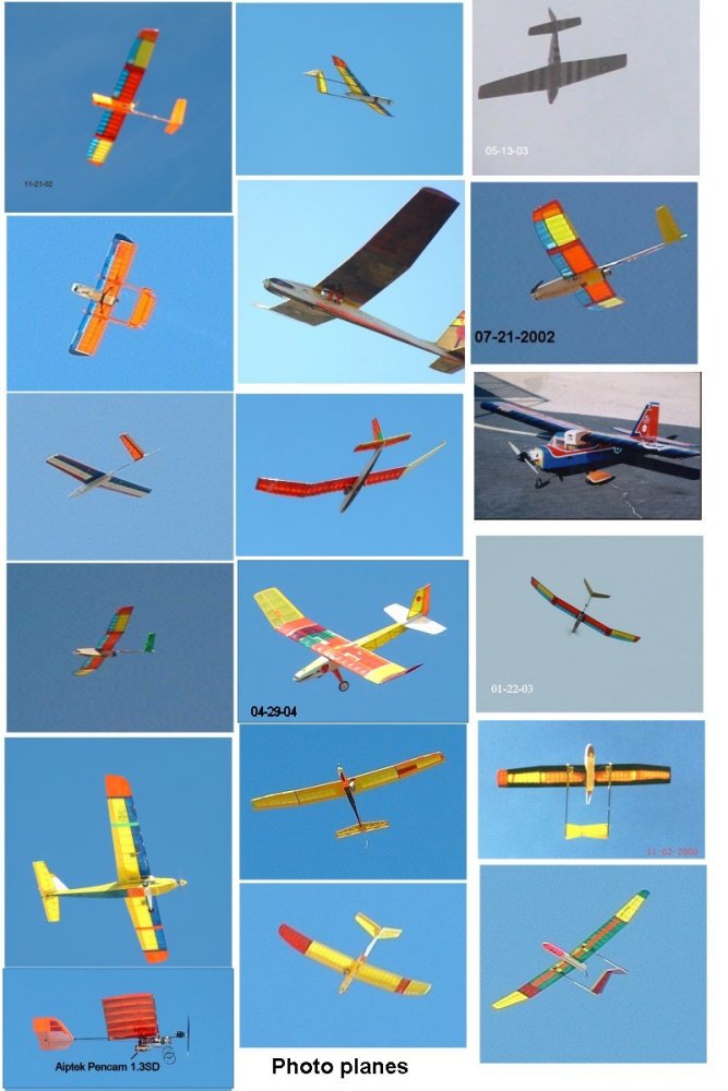

This one had an extension shaft on the motor, carried a film camera, and needed nose weight.
That's a Gentle Lady wing.
I've tried a lot of shapes, and find a conventional wing-tail plane is easiest to work with.
The need to fly straight and level without too much effort devoted to flying, while concentrating on the position of the plane and the camera relative to where you want it to be is most important.

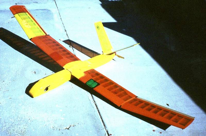

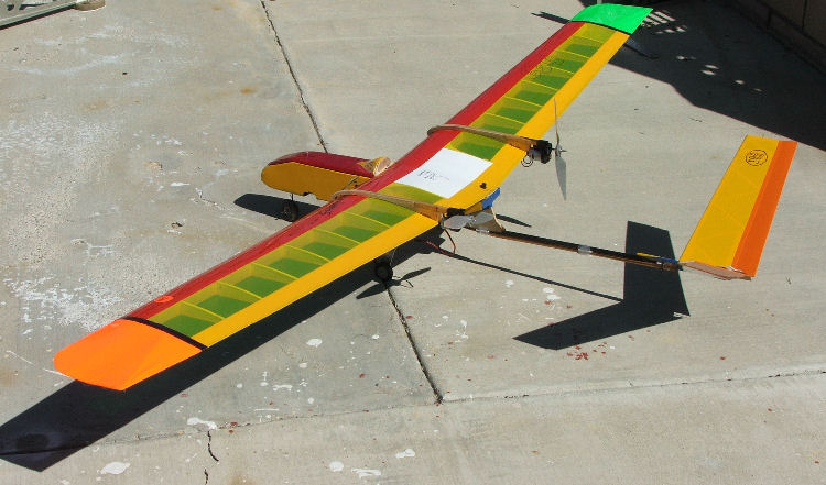

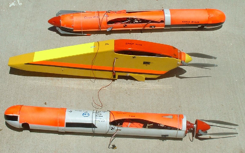

I've flown the GP Spirit 2M wing up to 65 oz with a AXI 2820/14 with extremely good performance on 8 Nimhs.
These all use the same wing.. the motor position dictates the nose length on the pushers.
On the pointy one, the camera is under the wing.
These all have a 90degree rotating camera mount, to look anywhere from directly down to directly to the side.

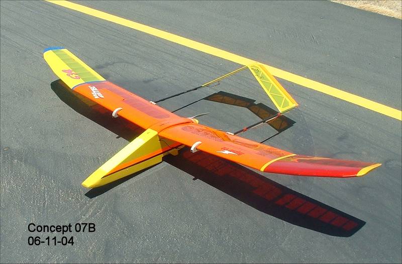

I've never seen a v-tail in that configuration before. How did it fly?
In reguard to the polyhedral, what percentage of the wing? Just a rough guestimate of your wing is about 30%
The inner panels have 2 inches at the break.
The outer panels 4 inches each, measured up from the inner panel flat on a board.
The pod and boom is popular for AP, especially with electrics.
Lots of prop clearance for a pusher.
Workable configuration are many...
