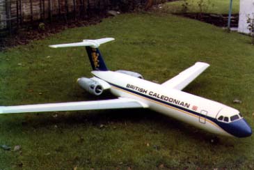

Higher is not always better, especially if high alpha flight is on the menu.
The Britsh had severe problems with the BAC 111 due to deep stall conditions associated with a T-tail configuration.
Tests indicated that at high angles of attack near and above those associated with wing stall, the low-energy wakes of the stalled wing and fuselage-mounted engine nacelles impinged on the horizontal tail and significantly reduced its stabilizing effect. Also, the low-energy wakes severely reduced the effectiveness of the horizontal tail as a longitudinal control. These characteristics manifest themselves as an insidious poststall condition in which the angle of attack of the aircraft would increase to very large values (in excess of 40 degrees) in response to the loss of stability, and the pilot would be unable to recover from the condition because of the loss of horizontal tail control effectiveness. During this entire sequence, the attitude of the aircraft fuselage would vary over a relatively small angular range, and the uncontrollable aircraft would descend steeply in an almost horizontal, wings-level attitude with a high rate of descent to an unsurvivable crash.
/Red B.
/Red B.

High Alpha flight is going to get you - no matter where the stab is placed .
On a model anyway -I don't fly the BAC111 so - I am only guessing on that one
last Sunday - a friend was flying my scale model of a 260 Extra - doing high alpha flight right over the runway -at about 30-40 ft and the engine abruptly quit ( fuel tank disloged and fuel flow stopped .)
He had no chance to drop the nose and regain forward speed so -he just held full up (about 50 degrees on elevators)
The model weighing 13 lbs - on 1150 sq inches - simply fell absolutely flat - with no more than 30 ft forward flight -right to the runway. This drove tailwheel into rudder - mains thru fuselage engine upward etc..
,It showed - again -that stabilized high sink rates -which look like a controlled descent - are really killers .
On our foamies the inertia is so low -they just thump down with no damage. but same thing on angles almost vertical drop -
I don't se how stab placement could help/hinder this .
The business of downwash effect on the models is really far over imagined -in my book.

The high alfa tendency of T-tails that Red B. described is a very common phenomena among T-Tail business Jets. The wing !QUOT!washes out!QUOT! the tail and renders it ineffective. On an extra the tail is, for the most part, in-line with the wing. For a T tail what would actually happen at high alfa is the elevator basically would not work and cause the aircraft to violently pitch nose down. Or at the very least cause the plane to begin oscillating, possibly causing a possible lack of control. My spacewalker actually has this problem on landing, and it's not even a T-tail. I can tell because when I slow down to land I have to be very careful not to over correct the oscillation.
Bottom line, for structural reasons and aerodynamic reasons, leave the tail close to in-line with the wing.
