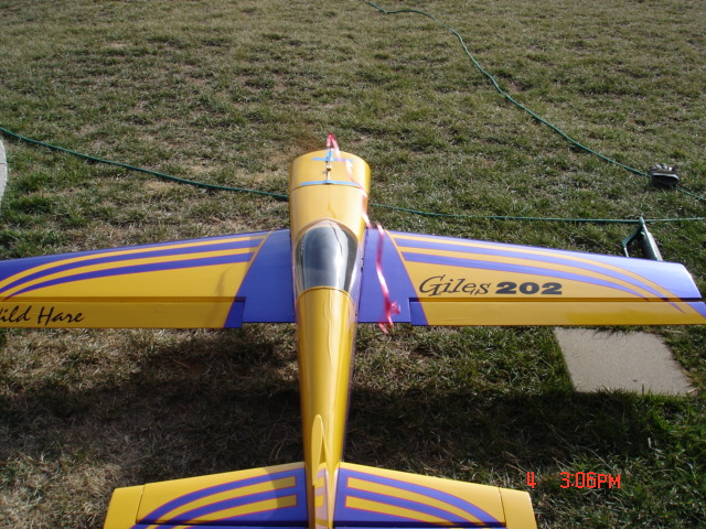

ORIGINAL: aspectratio
steck79,
I tied a piece of ribbon to my antenna with a piece of string once. Every time I went out in the wind it twisted up the string in the same direction. Could it be something like that?
steck79,
are you saying that it rotated into the free flow of air of the wind? Or behind a propeller? My experiment was at the end of a plane, thus into the prop airflow...
#104
stek 79,
I was wondering if it rotated in any strong wind or just in the propwash? It you stick it out the window of a moving car does it rotate?

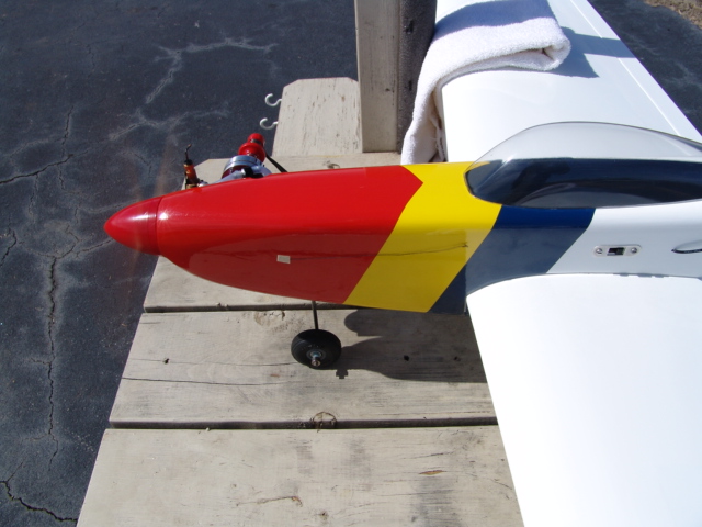

#105

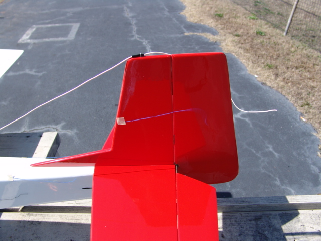

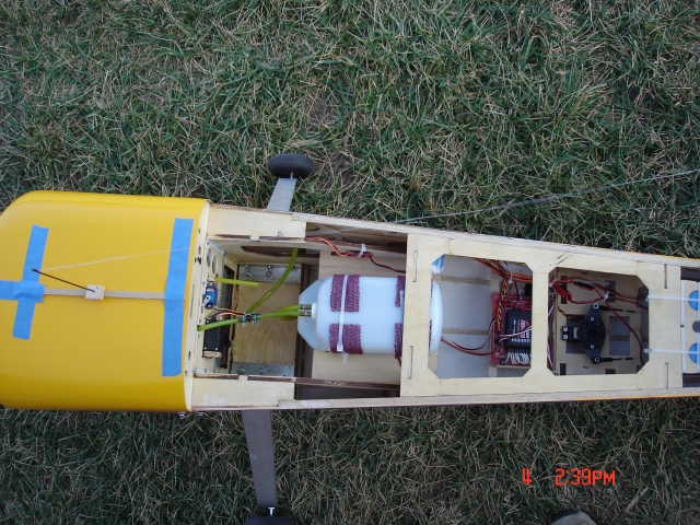

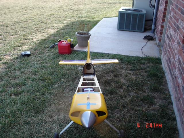

My Feedback: (17)
For what it’s worth. The first image is with the engine stopped. The threads flutter and swing back and forth in the air stream and the camera freezes them in whatever position they are in when the exposure is taken. From what I saw first hand, the center of the thread flutter and swinging was straight back from the tape holding the thread at all test points. The aircraft is a modified Tower kit built Kaos 40 powered with an Irving 53 ABC.
Your test results may differ depending on aircraft size, etc.

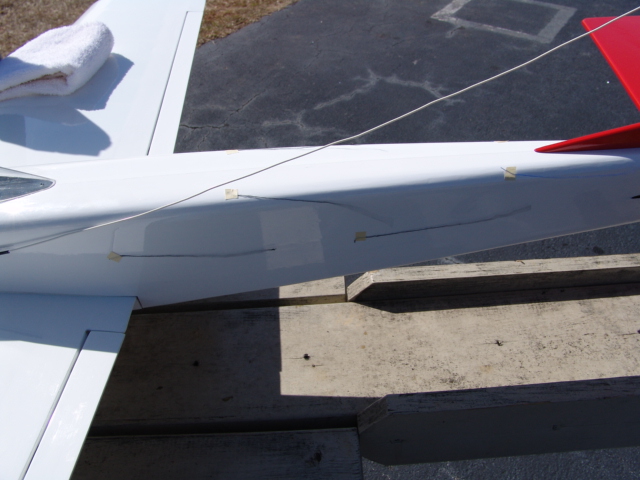

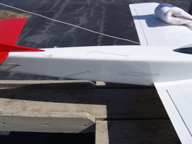

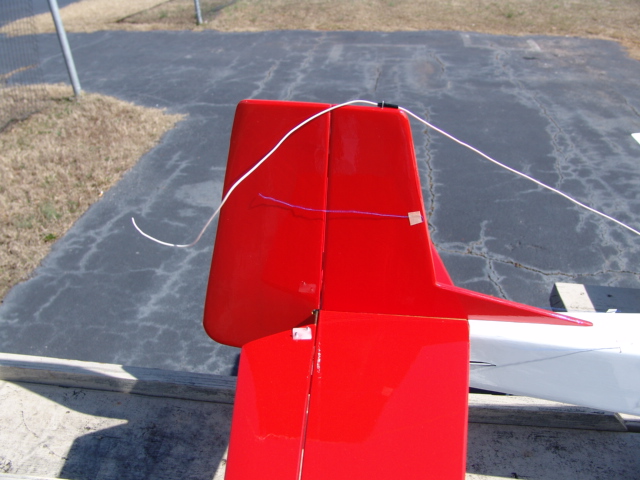

#106
Now this is what it's all about!
The left nose streamer appears to be angled in the expected direction relative to the slipstream core (prop shaft axis) a few degrees and fully extended. Check.
The left rear quarter side streamers also appear angled slightly in the direction of the expected spiral component. The streamer closest to the wing may be encountering some effect from the wing. The ones on the upper corner appear to be encountering turbulence and vibrating--not fully extended-very turbulent airflow. Check, and hooray for NACA.
The left side vertical tail streamer is angled as expected, and fully extended, obviously encountering high speed flow impinging slightly on the side of the fin. A big Check.
The right side vertical tail streamer is also angled upward slightly -- not as initially expected, but it has a kink in it and is somewhat slack and hanging away from the fin slightly, leading me to believe it is not encountering strong airflow, which is still in line with the spiral slipstream observations/theory. The effect might be slightly stronger than I expected. I think that's another Check.
The streamers on the top of the fuselage appear to be responding to turbulence, possibly from the canopy. I Dunno.
The right rear quarter streamers don't appear to be encountering high speed flow--the aft one is angled perhaps too far in the "expected" direction, and the more forward one might be in a turbulent area as it appears to be pulling slightly away from the fuselage and vibrating. This also might be due to an effect of the wing and/or canopy. The further aft streamer is a check. The more forward one is inconclusive. In total, Check.
Of the 11 streamers I counted, I think the behavior of the majority can be understood to be influenced by some spiral component of the prop slipstream. There are only four that appear to be shielded from the effect entirely due to turbulence--the four near the upper aft corners of the fuselage, and possibly another two just behind the wing on the right side of the fuselage. Since it is behaving differently from its mirror, that indicates an asymmetry. Check.
The fact that the four streamers on the sides of the fuselage are behaving differently from their "mirror images" seem to point to some asymmetry between the left and right sides of the slipstream--as expected, and this could be due to spiral slipstream, offset thrust, an outside wind component, or some asymmetry in the way the streamers are mounted (i.e. not perfectly mirrored left and right). The streamers appear to be fairly symmetrically mounted, and the offset thrust is probably small on that airplane, if it has any. The aft component of slipstream is clearly the largest influence on their behavior.
I say it strongly confirms the existence of a spiral component in the slipstream. BTW, if torque exists, which we all know it does thank to Newton, the the slipstream MUST be spiraling at least a little bit initially as it leaves the prop. Torque is weak compared to thrust, and the spiral component of slipstream is weak compared to the aftward component. If a wing drags some air forward along with it (which it does), then certainly a propeller does too, as we all know a prop is a rotating wing. It all makes sense.
Anyone else want to take a stab at an armchair analysis?
#107
My Feedback: (17)
As I said “The threads flutter and swing back and forth in the air stream and the camera freezes them in whatever position they are in when the exposure is taken. From what I saw first hand, the center of the thread flutter and swinging was straight back from the tape holding the thread at all test points.” The ends of the threads moved about 1/4” to 1/2” in either direction from center, but the center of the flutter on all test points was directly behind and down stream from the attachment points. I was unable to detect any spiral air flow at any of the test points. The engine on the Kaos has “0” right “0” down thrust.
If there is spiral air flow it is very weak and invisible to the test threads I used.

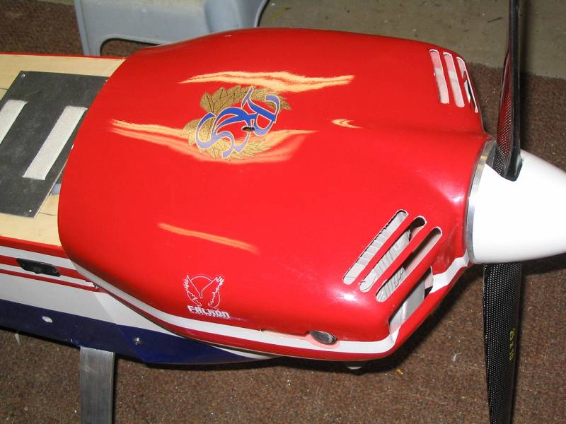

I have played around with my electric Typhoon some more. It has a molded, rounded fuselage.
I run the motor up and down indoors. There is no doubt that with even just minimal throttle, the threads blow straight back, and with full throttle, same thing.
I have a large 3D prop on it. Sometimes, if I just give it a blip of throttle, just enough to get the prop to twist five or six times, then I can make a thread on the top center move from hanging on the left to hanging to the right. Not every time.
I am going to play with it some more, but at this point I am thinking that the slip stream twist is very quickly overwhelmed as rpm increases and the prop begins to "fly" and move large volumes of air aft. What ever twist there is, it is not enough to visibly deviate a thread on my Typhoon at minimum or maximum throttle. Maybe it is one degree or two, the threads flutter, but it is certainly nothing obvious.
As I suspected. Thanks for sharing that experiment.

OK I did it. I took my plane out to the side of the house, using fine white thread mounted several inches from the top of the cowl on a wire, with the plane facing into a light wind such that with the engine off, the streamer didn't favor one side or the other.
That was a little hard to see on photos so I took it to the most sheltered area outside my house and used red ribbon. The wind reaching the area was very light and variable. again I positioned the plane so the streamer didn't favor one side or the other before starting the engine.
I mounted the streamers on a 5" (or so) piece of wire, holding it well away from the slipstream core, because I reasoned that the effect would grow progressively stronger toward the propeller tips, since the tangent velocity of the prop and therefore the spiral is MUCH higher there, which might explain why thread taped to the side of the fuselage (or oil on the fuse) does not show the effect as conclusively.
As you can see, the spiral component is unmistakable, especially considering the engine is mounted with right thrust, which would tend to decrease the angle the streamer makes with the fuselage centerline. I even altered the position of the plane for some of the photos (the head-on picture is one) so that the light prevailing wind tended to decrease the angle (blow it back toward the fuselage), and at relatively high power settings (1/3 throttle), the streamer still spent by far most of its time on the right side of the centerline as long as I didn't angle it with too much of a crosswind. With full throttle, the crosswind might not have mattered much. The streamer did come over to the "wrong" side a few times, but only briefly each time. The streamers clearly and overwhelmingly favored the right side of the fuselage centerline. This can also be seen in the videos I shot.
You can't see it in the photo, but I was protected by a pipe while taking the head-on picture, in case the plane broke loose. I always try to be safe.
I never exceeded about 1/3 throttle because I was nervous about the stake coming out of the ground. It probably wouldn't have, but I didn't want to stress the tailwheel either, and I didn't have a spotter.
I have a few short videos too. I'll try to post them and edit this thread with links when I get that done. Sorry about the tiny, low quality videos; cable and DSL are not available in my neighborhood yet. I think I'll only post the smaller videos with the red ribbons for now. The first two vidoes with the white thread show the same result under less favorable conditions (more wind), and are much larger files.

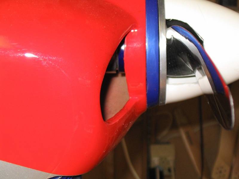

On a related note -- cooling our model engines is also related to the spiral output of the airscrew .
The prop does not -as some think - blow air into the cowl inlets.
It just stirs up things .
Then
The air flowing over the cowl, creates a low pressure at outlets/vents/louvers-which is replaced by air in the cowl-so the inlets of the cowl only provide a make up source for air flowing thru th cowl.
On full scale the cylinders are well ducted to really make the airflow hug the engine fins --and PULL the air thru to th outlet.
On my CAP and my Edge -I tried two other tricks -whch seem to work:
the Cap got vents added alon top the cowl - to receive air further from the hub area air and above the engine - this helped the internal flow to start above the engine -then down and out . Made an instant difference in temperatures .
On my EDGE-- I simply added a extension to the front of the cowl - to again extend the distance from the prop -to the cylinder (located at lower left of picture) and the scale inlets - the idea was the same to hopefully gain access to air not simply stirring at the hub.
Spiral flow is spiral flow and the prop twist at the hub area does really nothing to add rearward flow of air- so These approaches were done to help create some positive pressure in this area. The Cap is flowna lot at shows etc., now by a friend and is constantly staggering along at high AOA and the engine HAS to be kept cool .
