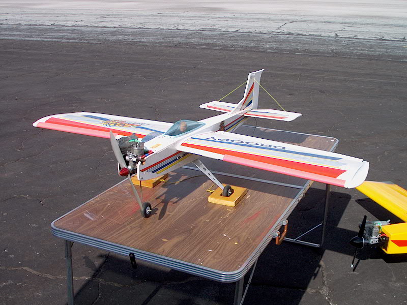

I've been messing around with a cheap, high-wing "trainer" that's .46 size. I got it for two reasons. I wanted a beater that I could use to break in my new OS.46AX's and I wanted to play around with an airplane that had anhedral.
This ARF seems to prove the idea that the asian ARFs are being put together by people from the toy industry who don't have a complete grasp of flying models. But that's another thread..... Bottom line is that most of the effort so far has been to get the sucker sorted out. I haven't had much time yet to see what the anhedral does. I've mostly been flying and fixing. But most things are now fixed and the last couple of times out I've been able to check out "what anhedral does".
The wing is a semi-symmetrical. It definitely isn't flat bottom. Heck, almost none of the "flat parts" of this thing are flat or straight.... chuckle And I think it really might have been "designed" to have dihedral but that's irrelevant. The wing joiner fits into the wing boxes with so much slop that you actually could set almost any anhedral/dihedral you wished, if you ignored the angle of the root ribs. So I cut a new plywood joiner that gave 2.5degrees and fit the boxes as good as possible, and ground the root ribs to match my 2.5 (instead of their ~1degree anhedral). Anyway, the wing is semi-symmetrical and it appears that, at least with my model, the airfoil varies a bit in the two sides of the wing. One side is actually flatbottomed from the spar back to the TE while the other side of the wing never quite flattens out. That side is curved just enough that I believe it had to be the result of the ribs' shape, not just lousy construction. So in other words, the way the model flies might have something to do with the different airfoils left to right.
Back to anhedral...........
First thing I wondered about was which way the model would roll when it was yawed with the rudder. I've flown a bunch of dihedral rudder/elevator gliders that get their roll from rudder yaw. And I also wanted to see what rolling an anhedral airplane with it's ailerons would do to yaw. Two different situations, even if somewhat related or at least situations that're often confused.
But I ran into something that stopped me from testing roll induced yaw first.
Rolling the plane with ailerons might be somewhat obscured by the lifting airfoils. But with equal aileron movement, my model did have an obvious yaw to the outside of the turns. This was fouled up somewhat by the model's large difference in roll rate. It will roll to the right or clockwise at the rate I expected. It is extremely slow to roll the opposite way. I've tried to make up for the different airfoils by ironing in a bit of twist. The plane still has an obvious, although less pronounced difference in rate. It is still taking some aileron trim, but that's another story. (The ailerons were already hinged.... you can guess..... I've cut one off and reattached but really need to do the other as well.) I figured I needed to sort that out before I could rely on the yaw test giving realistic results. So I redid the worst aileron and twisted the wing some and.... There was still a fair amount of opposite yaw even after the roll rates were closer.
I've setup another servo output "wheel" so I could try differential aileron and that has reduced the yaw coming from the aileron roll. I figured I needed to reduce that before I tested the real question..... what does yaw cause the airplane to do when combined with anhedral? does it cause "opposite" roll or what?
With my model, when I try to do a flat turn with the rudder, just the thing that causes rudder/elevator gliders to roll into the turns, I get....... taa daa......... somewhat of a roll into the turn. And it appears to be about the same turning left as turning right.
So...... after all that, I'd still like anyone who has some experience with anhedral to share with me what they've experienced. Truth is, I think my little bit of experience isn't trustworthy owing to the lousy test tool. I plan to build a clean wing for the sucker (wish I'd done it right away as a matter of fact) and test again, but that'll be awhile. I got a KYOSHO P40 and a Corsair and a Cap232 (just putting the radio in as we speak) in line first......

A low wing with dihedral becomes a high wing with anhedral when flown inverted.
As you lower the dihedral, you can expect less yaw roll coupling and at some anhedral angle, there will be zero yaw to roll coupling...meaning that the rudder will only yaw the plane without causing any roll. This is desirable in a pattern plane, it lets you use top rudder in a knife edge without haveing to kill the roll with opposite aileron.
I removed the dihedral on one high wing trainer and loved the results, much better aileron response and much easier to fly inverted.

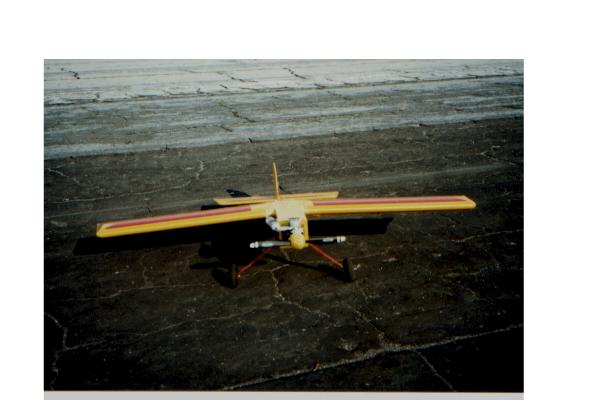

I have flown many high and shoulder wing planes with anhedral to correct roll with rudder and have yet to find nd downside to doing it. I have literally cut several wings apart to add in anhedral and just used heavy weight fiberglass cloth and epoxy to re-join the wing panels.
Here are the rules for dihrdral effect:
Dihedral, sweep back and a high wing location will cause roll in the direction of rudder.
Anhedral, sweep forward and a low wing location will cause roll opposite to the rudder.
Knowing this, you can understand why I tend to laugh when people think that taking all the dihedral out of a low wing will make the plane fly better. Several times I have had people with flat low wings fly level and put in rudder and watched the plane roll the other way. A flat wing only works if it is non-swept and mid located.
You have to balance the design for all these factors. Generally, 3 degrees of anhedral works pretty well. Most of the time I invert the dihedral brace, but if it is not enough, I cut a new one. I fill in the gap with an old piece of TE stock. You uslally have to trim the wing saddle for the downward angle and may have to use a rat tail file on the dowel holes.

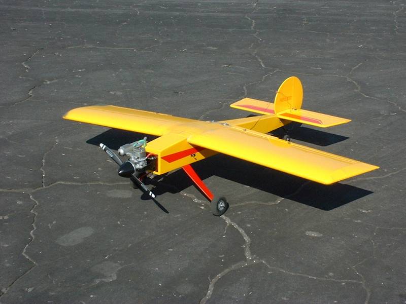

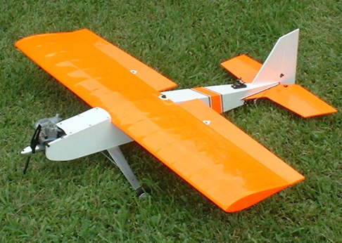

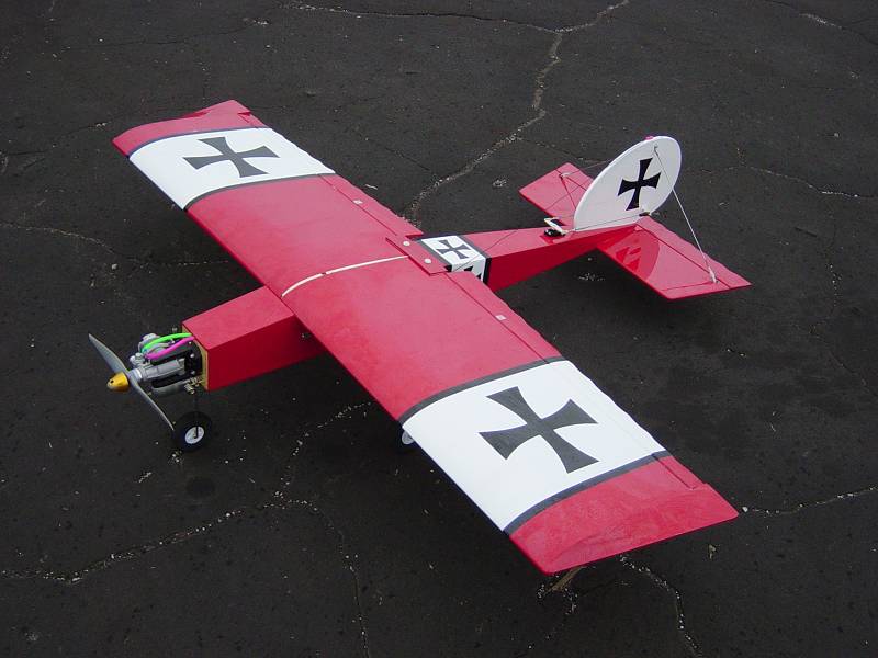

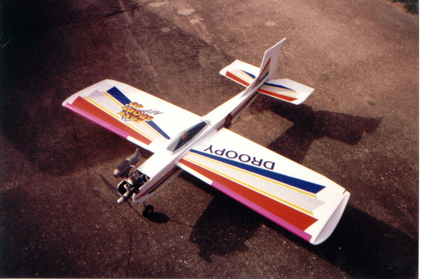

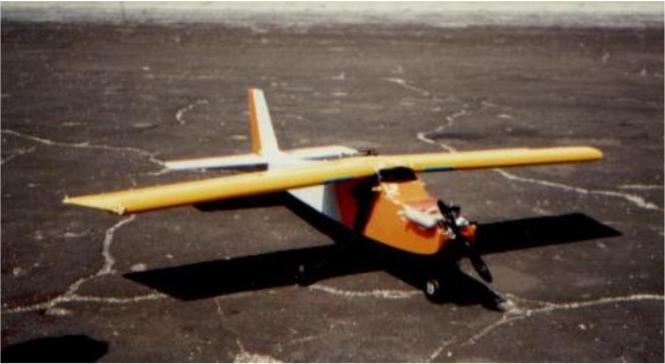

The first plane is a World Models Happy Fli with a piped .32
Second is an Easy Sport I modified with anhedral, 2" ailerons, 3" elevators and 4" rudder and .61 powered. Made a great little airplane.
Third is an old Eagle trainer with an ahhedral wing.
Fourth is another view of the Easy Sport.
Then there is a sort of MiG combat plane
Finally, a couple of shots of a Joss Stick with anhedral. The Joss flies excellent knife edge.

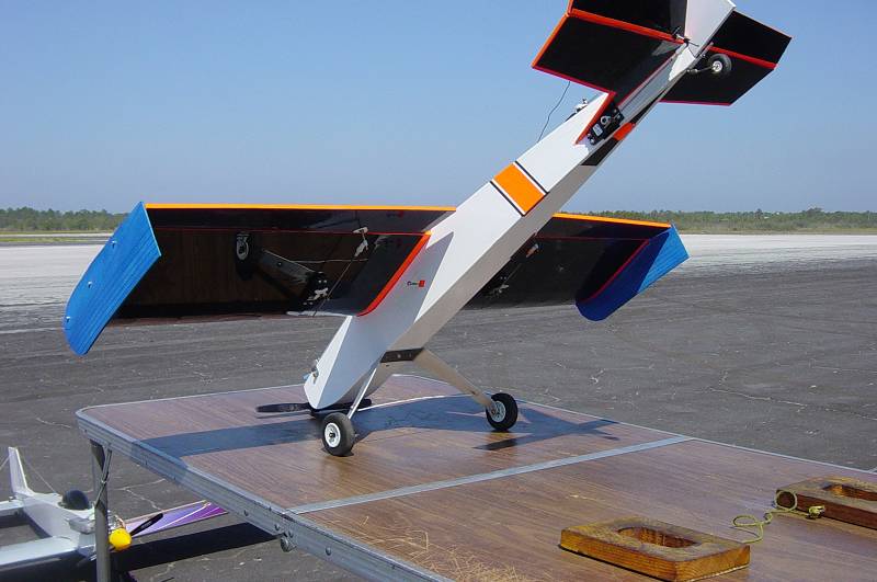

I have to include my Big Stick. It has an inverted dihedral brace which isn't enough. It does need more to cancel roll.

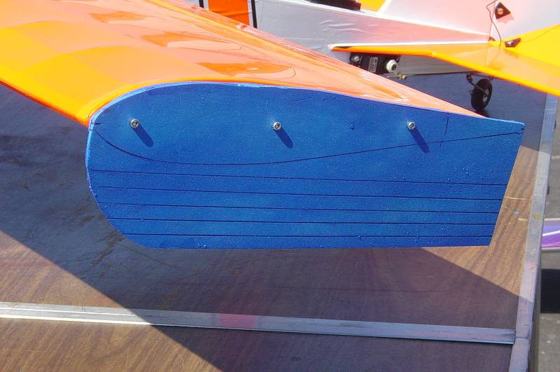

If you don't want to cut your wing apart, you can add downward end plates as shown on a Little Stick. These add anhedral effect, cancelling adverse roll. The original Little Stick is shown without plates. I added lite ply plates, hanging down 1 1/2". These were lined off in 1/4" spaces. I flew and it rolled opposite to rudder. I then trimmed off 1/4" with some Craftsman shears and flew again. At 3/4 inch, the roll was pretty much killed. That's the way they are now. I use this plane to break in smaller engines, .20-.36.
