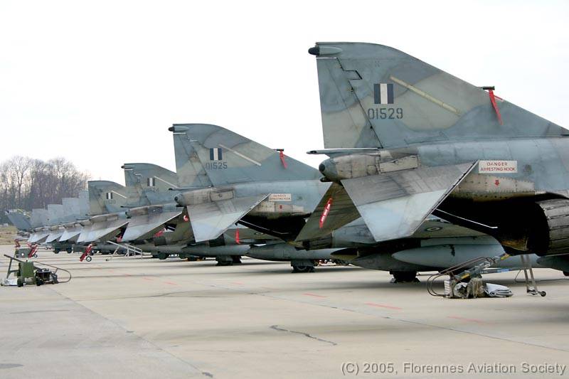

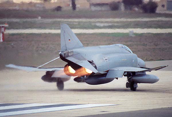

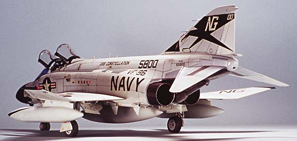

but then the stab would be way too high, so the anhedral brings the tips back down (logical design solution) also notice the unpaited (natural metal) portion of the stab& tail near the burners on any paint scheme>>> the paint would probably peel off due to the heat factor...[X(]I love those Phantoms!!!!!! [sm=thumbup.gif]
ORIGINAL: vasek
I think it's quite obvious (that) on the F4 the stab had to make "way" for the two "burners" in the back ...
I don't follow your argument. If the anhedral had anything to do with the burners, why would they swing them down closer to the exhaust, then make them heat resistant, rather than just leave them up there horizontal at the attach point, unless there was a compelling aerodynamic reason for the anhedral?

Look at the pics again.... the tips of the stab are not "heat treated" > its the center section which is in the line of "fire"... thus was moved up as far as could be... obviously not far enough so it had to be heat resistant... this is the reason the attach point is so high and the tips of the stab were brought down closer to the thrust line... thus the anhedral

If the anhedral had anything to do with the burners, why would they swing them down closer to the exhaust, then make them heat resistant, rather than just leave them up there horizontal at the attach point...
[/quote]
if i understand "why would they swing them down closer to the exhaust, then make them heat resistant" you mean the tips are swinging down BUT they are NOT heat resistant because they are pointed away from the fuse & the hot zone... don't follow what youre saying... yes the middle part is heat resistant & even if the stab would be horizontal, the middle part would still be in the HOT ZONE ...
[/quote]
[/quote]
