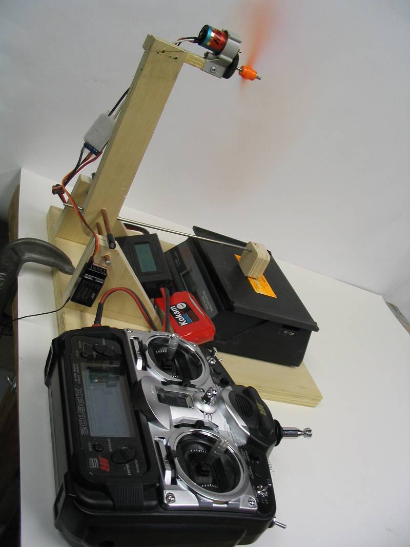

I try to resolve stuff like"prop efficiency" by testing
the math is a poor second on these questions
On my electrics, I simply stacked 2 blade props some with same pitch some with different pitches and diameters
The way I checked the results, was by measuring thrust and watts consumed at given thrust. I made a device to check this type of stuff.
My thrust stand -which I developed and shared over the internet - is now available (some body glommed onto it) is now available commercially!
my, my.
The really funny part --
when I first showed the device to the internet-- a number of guys doubted it could be accurate because the thrust was not measured in direct pull.
Anyway -the mixed props were pretty similar in thrust with 2 blade props-IF you compared watts to thrust
said differently - the thrust was the same when the power used to turn the prop(s) was the same.
