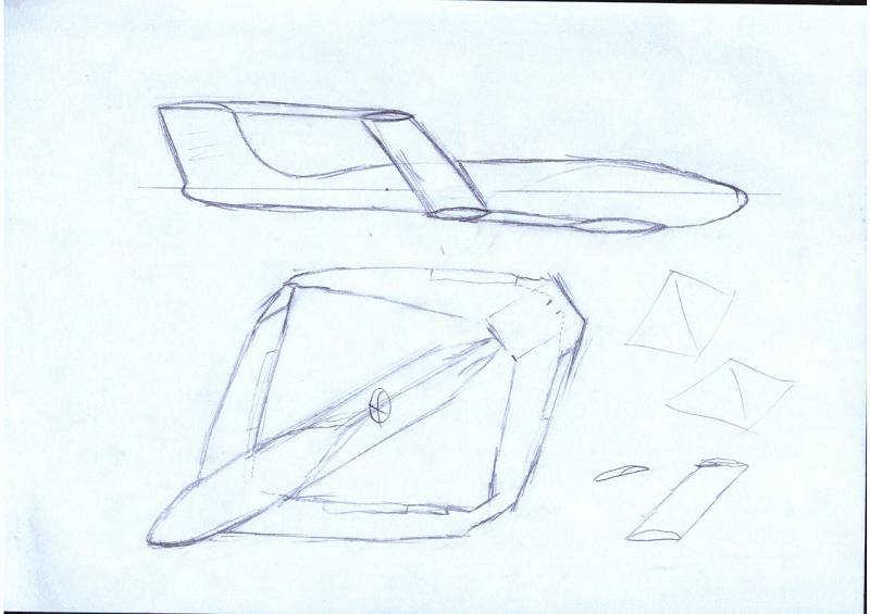

Hi guys. This is my first time posting here. So let me introduce myself alittle. Im a student in Singapore, very interested into flying hobby but still novice. Coincidently & fortunately, I have been given a project about it too.
I need to design an airframe thats small(within 20" wing span) & still a slo-flyer. I have thought up of a few designs but not such how feasible are they. One of which is attached here. I have gotten the idea from [link=http://www.aero-space.nasa.gov/docs/ar00/]here[/link].
Its a combination of swept-forward & swept-backward wings. Im thinking of using foam to build this. What do you guys think?
I welcome any commments & help here Please. Thanks in Advance.

The format has been done before but I don't recall the exact name for the style.
However how much of a slowflyer it is will be determined by the usual factors. How light can you make it and how much wing area can you build into the model. Wingloading is the key. The lower the wingloading the slower the flight.

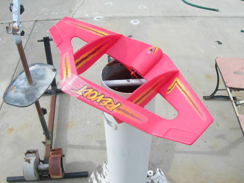

There's a couple variations on this foam free-flight... It kinda flys, but is very fragile.. It would probably fly OK with r/c.

There's been some very pretty looking concepts done using the joined wing style but a quick google search didn't really find them. I also found that the style is reffered to as a box wing like you used but I always thought of a box wing as more like a biplane with full tip panels much like the Santo Dumont canard biplane.
Anyhow, I did find some sites with the term "joined wing" so there's info out there. In the meantime there's no reason that you can't get your own design tests running. Make some models out of sheet balsa as simple test gliders to experiment with stability and CG placement and have fun with it.
A lot of a normal airplane's drag comes from the energy taken to form the vortices at the wingtips. The joined wing idea, if done well, may be one answer to limiting this loss. Some variations would certainly be fun to play with.
