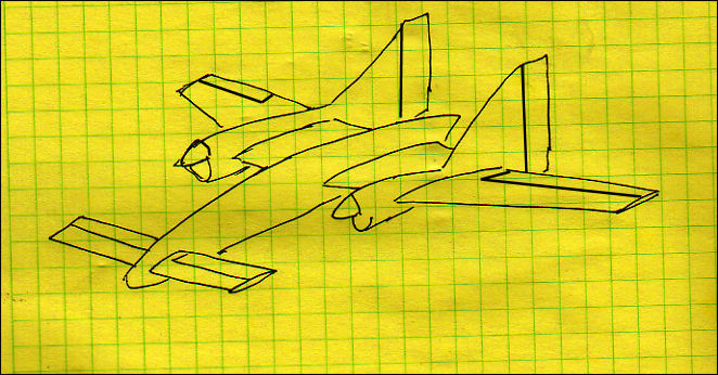

When you mount the engine on the wing using a nacelle does this effect the lifting properties of the wing? Does it effect the MAC math? What are the drawbacks of the regarding a tractor type setup for engine on a wing is what I am asking?
I would prefer this type of setup over the pusher type of setup, I normally see used on a canard.

You might describe the plane better... is it a wing-tail airplane, or a flying wing?
I see lots of canards with pusher motors at the rear of the wing..
A tractor motor on a canard is rare.
".. a nacelle..".. ?
Nacelles are generally used with twins.
And have no effect on the geometry

Paul you are right nacelles are used with twins.
what I have in mind is basicly you standard canard, but using twin motors on the wing. I did not want to use the tractor set up up front because that would direct air over the canard and would keep the canard from stalling before the main wing. Also the weight in the tail construction of most pushers does not seem to me to be all that good of an idea. I was thinking that if I located the engines/motors on the wing I could bring more of the mass toward the MAC which I think should improve the over all performance of the aircraft, or am I wrong about that. the other thought was to install the vertical stabs and rudders at the back of each nacell to provide more rudder control which seems to be an issue with any canard I have seen. And yes I am aware of the issues involved with a twin or multi engine hence the vectored thrust idea with the rudders....

It's just a sketch..
I'd never build one... too many fragile parts at the front on a canard.
The Starship doesn't have a lot of vertical area.. I suppose some of it comes from the props.

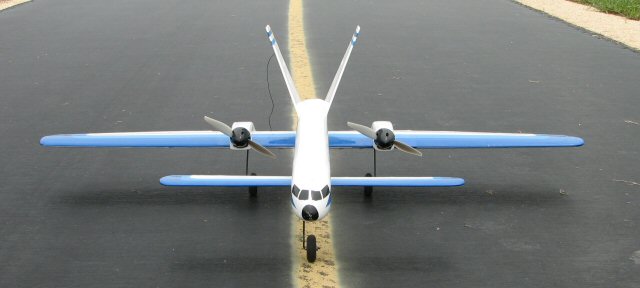

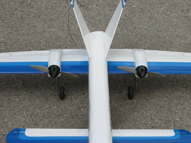

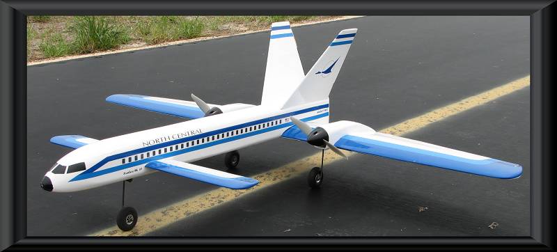

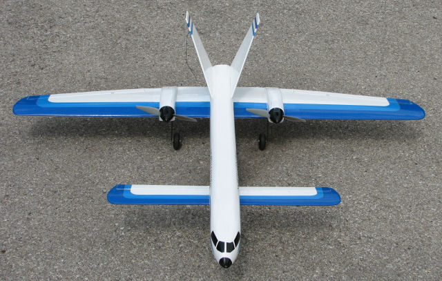

Iron Eagle,
You mean like this one?
This is my original StarLiner Mk III. I removed the .45 glow pusher and stuck on 2 AXi 2814-12 motors running 3s Lipoly on 9x6 APC e props. 6 lbs ready to fly and it goes like mad!

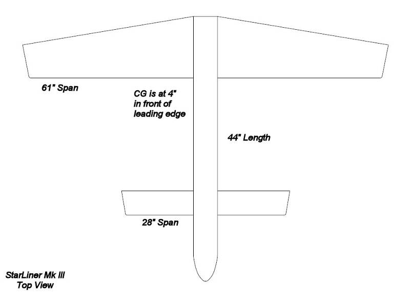

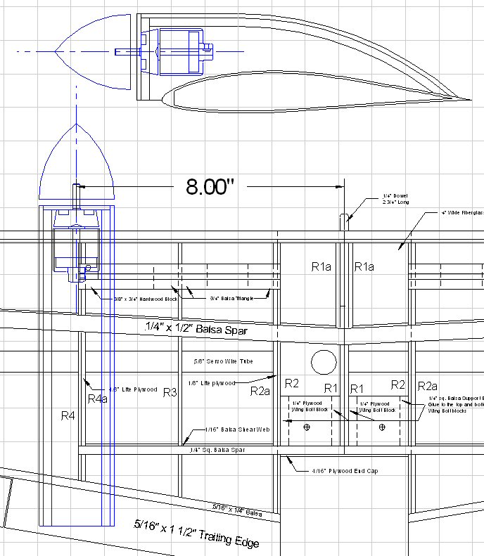

Ask and you shall receive...
Attached is a top view with the basic dimensions and the CG, a section of the plans showing the twin mounts, and a couple of pics of the plane. I have not finished the plans for the twin yet, getting all my StarLiner plans ready for sale.
As to differences in flight between the single pusher and the twin, both versions fly virtually identical. The only "difference" I have found, is the noise the props make during high "G" manuvers, they rumble a bit from the turbulence off of the canard when the elevator is at full deflection in a high "G turn. The turbulence doesn't hurt anything, just makes a bit of noise.
