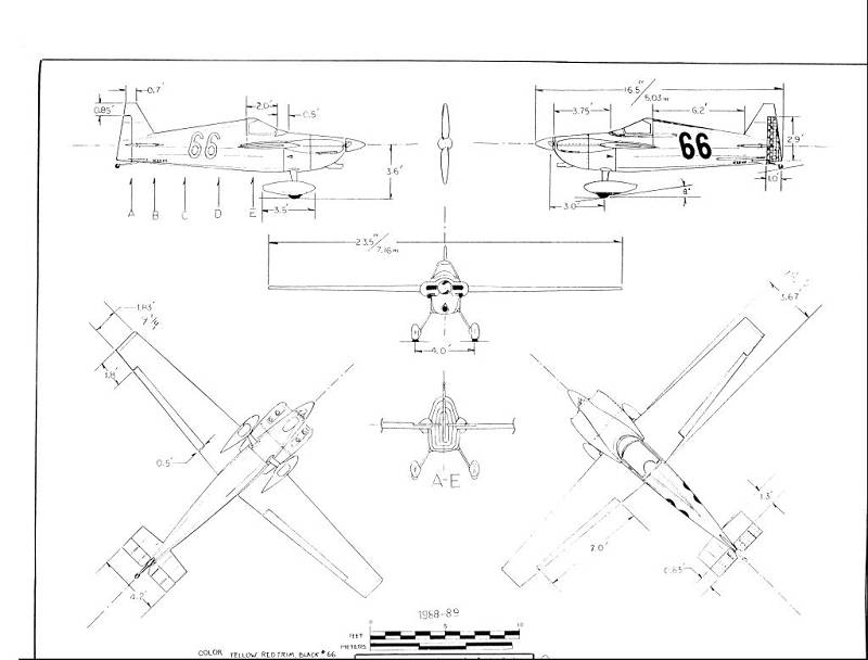

just to add-
I designed and built hundreds of pattern planes of many different layouts and wing loadings and airfoils etc,etc..
the structural part of wing design is hardly ever mentioned here --but is far more important than the actual airfoil
a flat bottom with a curved top is easy to do and is -- a decent layout for strength -so --it is often thought of as a good airfoil
and it is . But
it really has little else going for it on a model
On full scale I have doubts of any advantage too- except it is easy to build.
Some full scale foils are intended to maximize a certian load and speed.
others for broad loads and speeds - which brings us to the airoils for the full scale EXTRA aircraft -- an extremely large blunt LE ,which simply transfers to straight lines to a thick TE .
this is literally a flat plate but thick enough not to break-and flies extreeeemly well over broad speed ranges
I never see it mentioned on this forum.

I thought the Cassutt was an extra wide chord 'Hershey Bar' wing and that the area with less span was one of the attractions.
See cassutt.lornet.com/
Could you explain the taper---- a plan form you haven't been too high on in the past???
There are a bunch of wings for the Cassutt
16 ft 18 ft rectangular --then some long highly tapered composite stuf of recent decelopement for longer course at Reno
A highly tapered wing for areobats is fine --as long as the span is not excessive - basically--they are very responsive as the mass is really inboard made light enough - they work fine
I tried this already on my Petrol Petrel
roll rate is a blur.
The rectangular is still the best at very low speed work - here are some examples - the 3view of the tapered is not the taper I will use . it will be like the red and white example.
