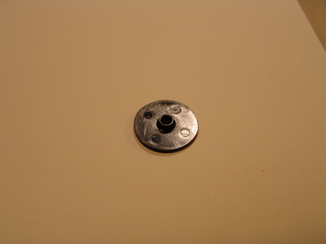

Step 1. Draw an arc that depicts the servo disk or the aileron control arm showing the servo center point. Differential can be created at either or both points.
Step 2. Measure the distance of the servo movement or aileron control arm movement with the normal servo throw and lay that out on a translucent vellum using the same arc used in step 1. Be sure to mark the servo center point on the arc.
Step 3. Next overlay the vellum over the step one drawing.
Step 4. Determine how much differential you want by rotating the velum. The further the vellum is rotated the more differential is created.
Step 5. Measure the distance the push rod will travel by using the vellum end points.
Step 6. The vellum servo center point becomes the point to attach the aileron linkage.
Pretty simple! I have no clue why they invented radios that can do this with programming when it is more fun to do it with linkage.
Or for less fun use the calculations in the chart in the next post!

Wm,
That’s why I like to draw it out on good old paper and vellum! It also lets you figure out the differential available by changing the angle of the control arm on the ailerons. The differential created by rising or lowering the servo position in the wing can also be analyzed. Years ago Kavan made servo output arm disks without holes that were marked in degrees and you could drill your own holes. Once you figure the differential for one aileron then you just repeat the linkage setup for the other side.

The "drafting method" 8178 suggests works well and makes it easy to see what's going on. You can't go wrong with that.
Over the years there have been several formulas and even computer programs to do the same thing. For several years I've used Blaine Beron-Rawdon's "Linkage Design" program. It's an Excel spreadsheet that includes an interactive schematic display of the servo and control surface that you can move over the full range of travel and watch what the linkage is doing. It also computes the hinge loads and the basic servo requirements.

8178194875...
I can remember those disks by Kavan. I think at the time though, most of my needs pretty well dictated a need for 90 degree or 180 degree holes. There was a poop sheet that went along with them to let the builder know how to calculate tne position for drilling the holes.
So who then wants to mark and drill for special holes?
I sort of wish they can ready for currently available servos, but there is such a variety of mountings available now. Square shaft, splined, and just how many splines too.

Pretty neat stuff Tony! Here’s Blaine Beron-Rawdon's website http://members.cox.net/evdesign/pages/products.html
Wm.
I think Futaba is still shipping this output disk with their servos. The disk is about 1 5/8†wide. I have some of the Kavan wheels around here somewhere that came with my Kavan Jet Ranger.

If you're happy with a 45 degree angle on the arm and the amount of differential that provides then you can just put a + arm on but angled so it's a X shape.
Remember too that when you're working with arcs like this that you are also introducing a non linearity in the amount of throw compared to the stick movement. Not so bad on the one that is pulling in Pauls second pic but on the other one that is pushing the arc travel is reducing quickly as more throw is used. So the differential %'s will be very low for smaller travel amounts and higher for extreme stick positions. But that's OK since the adverse yaw you're compensating for is more noticable with full throw than at small movements.
If the ail. horns are on the bottom of the wing, moving them back on the ail. and leaving the servo horns at 90 degrees will give the diff. too.
