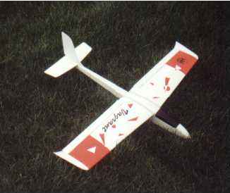

I have experimented a fair bit with breakaway tip plates on a competition fun-fly model, and found that they improved performance considerably - quicker loops, better handling near stall, and slightly faster roll. Large tip plates will reduce induced drag only at high lift coefficients - the saw-off point is around 0.5 Cl. You need to have roughly equal plate area above and below the wing. If you place more area above the wing, you get a dihedral effect which may be undesirable. It is far more efficient aerodynamically to simply increase the wingspan rather than using plates. Plates are useful for reducing induced drag within a given span.

Hi Volfy,
Your post range a bell with me and I have some positive data
on the use of pure winglets on model aircraft.
Several years ago I conducted some aerodynamic comparative
testing of several factors. One was to comparatively evaluate
with using them and not.
I had detailed winglet parameters from NASA.
Vehicles used were electric powered gliders (600 sq. in.), one a
canard. So that powered flight and glide could be observed.
Nasa had indicated a 3% increase in efficency with winglets. My
flight observations would suggest more than that, they diffinitely
improved performance. Rate of climb was greater with more stability, Glide was faster and flatter. No bad effects were noted.
The observations suggest a reduction in drag over normal tips just as NASA saw. The increase in stability was an unexpected asset.
Bottom line is they do improve performance at small cost.
However, first winglets are NOT tip plates. They must be properly
designed and installed with the proper alignment.
Possible shortcoming: improperly installed they can increase drag.
Ever wonder why Burt Rutan uses winglets on ALL his designs?
Good luck!
Hal deBolt

i did make some upturned wingtips for my small glider as the block gave pleanty to do this with. when i knocked one off i noticed no tip stalling, while it sounds like they dont work, remember the other tip is on the heavy wing now covered in solartex, so it at least canceled out that weight
