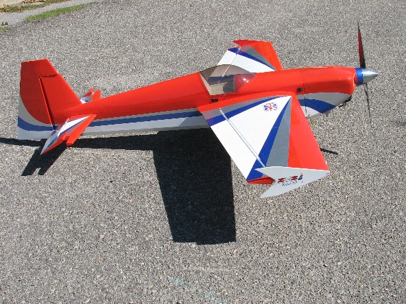

I added a similar setup to my Clipped Winged EDGE - so far -I see no downside to the short span and plates--on the model
Yeh -that's one thought
I looked at the setup I did this way --
I wanted to slow span flow at high AOA- (sorta like the Side Force Generator things)
But I did not want air to pile up at the aileron tip - the shape was my own idea.
So I decided that if I stopped em before the aileron LE- that would be a better compromise.
The plane lost 90 square inches ( and 8" of span) -was 97"- now 89") but no detectable increase in wing loading (weight is 23 lbs ) roll rate really did increase.
Every time I saw off span -I get a better aerobatic setup -but I start with prety low loading planes.
I am just now completing one of the GP CAPS with a Evolution 116 n tuned cans - I can't afford to try the sawed off wings till I see how the plane works first -wing loading is not low --as you know.
Then I saw the Velox setup--almost the same approach-
I don't know if the tips on the Velox were Velox's idea or Peter Besenyie's idea - or whose - anyway I was hoping someone did .

Your upper AND LOWER plates are going to stop a lot of air sliding off of the wing ends.
To me that means you get the 100% use of ALL your wing surface.
High rate axial rolls should not cause higher tip votices anymore.
Nor should vortices appear as bad with any tail sliding moves that cause 1 wing to become swept back while the other is swept foward.
Most Mig jets always had several fences along the swept back wings. They did control sliding air to the Wing tips.

Yeh--that's what I also thought - the puzzle is - if they work so well - why are they used so infrequently?
I kept mine small then flared at TE as that to me is the natural path the air will take -and the VELOX is even smaller -which I thot made sense as the efficiency of full sized stuff is better .
Why are they used so infrequently?
I would guess that for the fences like the ones used on the Mig the interference drag might be the killer. The fences were not tall, but they're pure interference from front to back and that's both sides of the fence. And from their front to back layout they'd be almost impossible to install cleanly. And for long term maintenance of a wing would be in the way of just about half the components that might require access.
We can more easily place fences on models and do it "slicker" and it won't get in the way of our maintenance men. Airlines and airforces won't see any positives about them.
As for why aren't tip plates used more in the real world? I'm guessing no commercial need. And fighter aircraft nowadays don't really "fly" do they?
