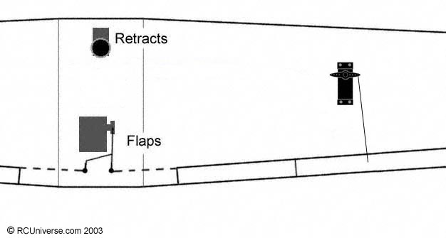

I have added flaps to several planes by simply cutting about 1/3 of the inboard side of strip ailerons, and each time I have done it, they worked incredibly well, and DID NOT make any significant loss of aileron control.

A simple flap of 30.058% chord along 17.3% span with a modified clark Y airfoil and 2.4% washout at the right wing tip and 1.2% at the left tip (we think it's cool when it spins to the left...) should decrease the stall speed by 4.6% of Vne. This is only if the engine spins a three bladed wooden prop and the elevator servo has 9.8% exponential in the wrong way. Mix the flaps with full left rudder and use right aileron to keep the heading right. (just cause the spin to the left is cool, right?)
