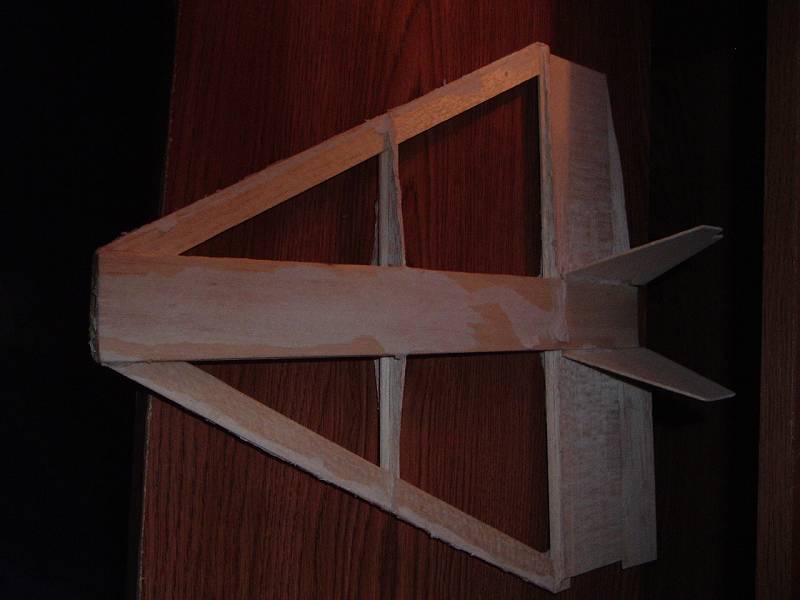

thanks Bobbler and Craig! I did build a half scale version of this wing, I hope you can see the pics. the balance point i found on the 1/2 scale version is about 5in from the nose of the wing, where you see the spar, thats where I had it balanced. It did glide well with about +3 deg on the elevons.

You'll want it to balance at about 22 to 23% of the MAC or Mean Aerodynamic Chord. There's links to sites that help you to find the MAC in the sticky threads at the top of the listings here in this forum.
