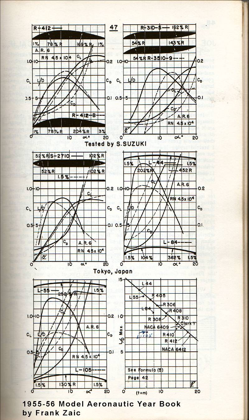

An airfoil like the well known Clark Y works best when moving forward and right side up, yet planes with this airfoil will fly inverted. I'm sure that it will also lift backwards and even inverted backwards. The shape is just not optimum in that configuration.

B.L.E., I agree that virtually any airfoil shape, even a clark Y, will lift forwards, backwards, upright or inverted, but center of pressure and pitch moments would change so dramatically that stabilising it would be a nightmare. That is part of the reason for searching for a unique airfoil which would offer consistant behaviour in those differing flight regimes.

Because the center of lift would jump from the 25% point from one leading edge to the 25% point from the NEW leading edge at the point of reversal you had better believe that the CG would have to move, and move a LOT. It would be worse than you think too since the CG position for what would suddenly be a canard would need to be closer to the new leading edge or even in front of the new leading edge. So some way to slide the main wing back and forth or some way to shift a lot of the heavy components and alter the CG that way is a must. At the same time the old vertical would have to snap into hiding and the new vertical(s) snap out and into place. Ideally this would be done at a low airspeed or right at the stall point otherwise the new configuration would be like flying an arrow backwards all of a sudden. Just think of a standard model noseing up into a stall and then BAM! the fin on the tail snaps into hiding and the wingtips snap up and back to form new fins while the innards run backwards on rails inside the fuselage to move the CG from the 35% mark from the new trailing edge to some point just in front of the new leading edge so you have a suddenly functional canard form.

By the way, a round airfoil will generate lift if you spin it. Of course, you would have to be able to instanly reverse the spin.

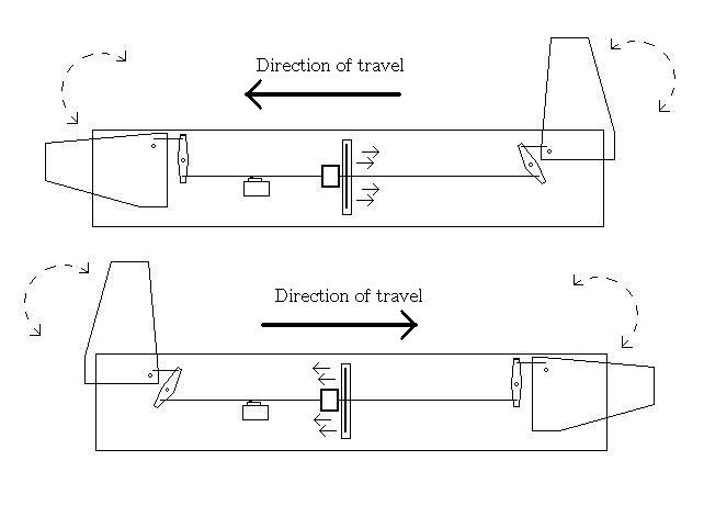

Ok bad (very bad) drawing... but here's a way the vertical stabs could be changed as the prop changed pitch. As the servo for the prop moves it would raise one stab while dropping the other. Tandem wings at ethier end of the fues. Maybe something along those lines?
Neat!
The goal should be taking all the area off the back when it becomes the front, and adding that same amount of area to the front when it becomes the rear.

ArmedZagi, thanks, I'll keep your idea on record, 'cos I don't have a better one. Yaw stability is a big question mark. But then, so is pitch stability! My friend here already suggested a tandem wing layout. After he described how it would work forwards and backwards, I asked him what it would be like inverted, and he said "No way!".
Tall Paul, that's right, but how? I think I can see why a reversing plane hasn't been done before (and may never be done!).
I spent some time with FoilSim today, specifically the elipse shape and the flat plate. I couldn't find any specific info on the C of P position, or the pitch torque or moment, for the airfoils in the graphic.
Does anyone know how I can get that info? Thanks.

In "Car & Driver" 30 or so years back Bruce McCall had a feature on fancy airplanes... one of them was a Italian fighter which could fly in either direction.. depending on who the Italian government was aligned with that day.
Back to the picture I drew earlier... If a weight was attached to one of the pushrods... As the rod and weight moved it would shift the CG of the plane.
I doubt you could put enough weight onto a simple pushrod to move the CG far enough even if it was literally a brick. The travel is too short.
You'd need a long threaded rod and motor to turn it and limit screws to shift a smaller weight pretty much from one end of the model to the other. Remember that mass times distance is the equation and to keep the overall flying weight down you need a lot of travel.
Or if the jack screw deal is too slow a tube with a pneumatically driven weight with controllable locks at each end would be quicker.
