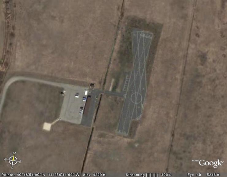

All my take offs are across the runway -If I hook or slice, I have a lot of runway to use ----
This is applied logic.
Old 01-28-2007 | 08:11 PM
Joined: Jun 2002
Posts: 5,211
From: Palmdale, CA
Default RE: Airspeed Mind Bender
Your runways are short, but really wide, I guess...
A good tailwheel can straighten out the takeoff, I've noticed.

rmh's Avatar
rmh
Posts: 12,630
From: , UT
yup 600ft wide and 50 ft long
Old 01-28-2007 | 08:53 PM
Joined: Nov 2005
Posts: 1,961
From: Auckland, NEW ZEALAND
Must be in Ireland somewhere :-) (Or really strong crosswinds?)
Evan.
