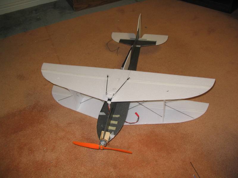

It would be very interesting to see some windtunnel studies of a biplane with wide vortex controlling interplane struts at the tips of the wings. I'm wondering if it would not be possible to gain a lot through that sort of control.
And for Dick interplane tip panels like that would allow for easy knife edge flight...
silver_moon_beam’s design faces a span constraint. Everybody here knows that a monoplane with a span constraint will have minimum induced drag when the span is pushed right up to the limit. If induced drag is your concern, you can "work around" the span constraint by adding another wing (biplane). The most efficient way to do this is to separate the two wings vertically as much as practical (i.e. without adding too much weight or profile drag). The reduction in induced drag for a biplane does not come from interference between the tip vortices as BFoote suggests. In fact, the less interaction between the wings the better.
Here's a simple "thought experiment" that might explain... suppose you are given a fixed amount of area for your wing (or wings) and you want to design a plane with minimum induced drag. Design A has a span equal to 8 and a chord equal to 1. Design B has a span equal to 4 and a chord equal to 2. Everything else being equal, design A should have lower induce drag. Why?
Induced drag comes from putting kinetic energy into the air. If you want to minimize the kinetic energy you are putting into the air, it is better to "push on two air molecules once than the same air molecule twice". If you think of design B as two "closely coupled" wings, this design is essentially pushing on the same air molecules twice to achieve the same effect that design A achieves by pushing on different molecules once (crudely speaking). Geese fly in a V rather than in a column for the same reason (the efficiency they gain is slightly higher because the outboard geese actually take back some of the kinetic energy that the inboard geese put into the air).
Separating biplane wings vertically (increasing the gap) minimizes the extent to which the wings are influencing the same air molecules. Design C with two wings of span 4, chord 1 and infinite gap is more efficient than a biplane with less gap, but it is still not as efficient as design A (geese don’t fly in a “stack” either).
How about adding vertical struts between the tips? Suppose you are given not only a span constraint, but also a height constraint for your design (i.e. your design has to fit inside a box of specified size). It can be shown that the design with minimum induced drag is a biplane with maximum allowed span and height (gap), with vertical struts between the wingtips (incidence of the strut panels is important). Why is this "box" design not more popular? Because the induced drag benefit of the vertical struts is usually offset by the profile drag and weight penalty.

A nit pick point Shoe. You are correct that increasing the Gap increases the efficiency of the wings because there is less interference for Lift. But, you are wrong as you spread the Wings on a biplane apart the interference decreases for Induced drag and thus you then have your "4" wingtip losses that are closer to 100% as the gap increases for whichever aspect ratio that you have. All of the old NACA reports show this, they weren't dumb, thus just didn't have our gagetry we have today. Think of whirling vortices on both ends of the wing. The top one interferes with the bottom one because they spin the same direction, thus the bottom wing vortex comes up and smacks the top wing vortex. Thus, for this reason a biplane with a staggered wing where the top or bottom wing is about 10-20% chord in front and about 10-20% longer has a lower induced drag and an increase in lift efficiency.
Yes, Box wing works great and decreases induced drag. A perfect winglet on a biplane is a bit harder to make as the twist angle from the top wing is opposite that of the bottom wing as they meet. But then who needs perfect?
My bro made an acrobatic bipe, weighed 17lbs with a heavy chainsaw engine and fuselage, where the wings were made of 1/4 balsa sticks for the main spars on a 78" span upper and a 72" lower. Both wings together + struts with canvas covering minus paint weight in at 1 3/4lbs if I remeber right. The paint to make the biplane look cool weighed more than the wings did together!!! Most modelers as Dick Hanson points out make their airplanes like bricks and lose the advantages of the biplane.
I would have to say that in a minimum sink competition that the monoplane is superior since they are working at VERY low speeds, Very low RE thus friction/stiction of air, since its laminar, on the surface is probably the driving factor in the competition.
