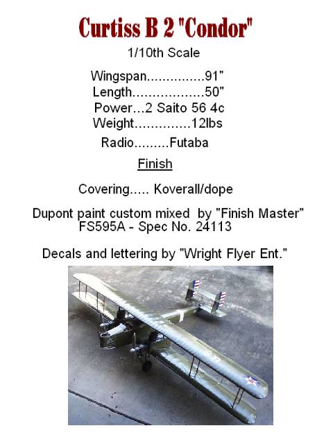

There was a B 2 bomber that not only had a rudder, but had two of them......
ID:	645788   Click image for larger version
