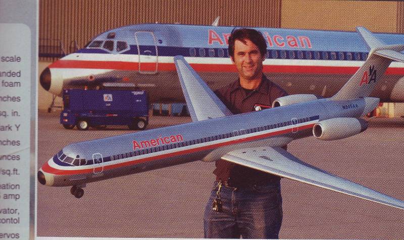

Take a look at Keith Sparks' beautiful Douglas MD-80 which was a construction article in the November 2006 issue of Flying Models. Wingspan is 84", weight 6lb.4oz. powered by two Mega 16/15/5 motors driving small pusher props which are hardly visible.
