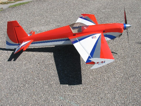

Old 08-10-2007 | 09:01 AM
rmh's Avatar
rmh
Posts: 12,630
From: , UT
Default RE: props and large round cowls
one inch on 16" prop isn't a lot
the radials used on the old WW2 planes were a compromise -just like airfoils - it is all a compromise and they used huge props to make it all work
on our little IC engines, the big props simply are too big to allow the engine to run in the power band
latr on - the benifit of moving the props as far forward the cowl as practical - and blending the spinner to the cowl - improved things

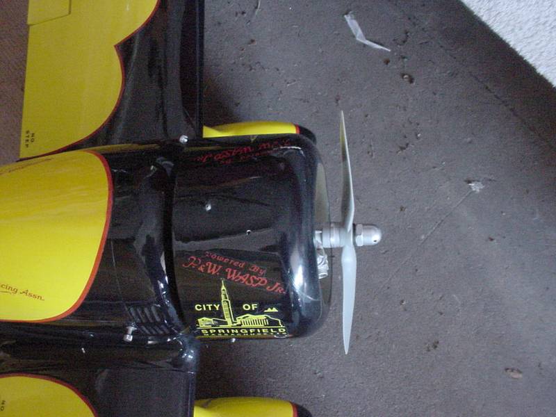

Personally I try to get the prop as far from the cowl as possible -on any model --

Old 08-11-2007 | 02:28 PM
Buzzed's Avatar
Joined: Feb 2007
Posts: 34
From: Mayberry, RFD
Little Kyosho Gee Bee with a OS 46. Prop is an APC 10-8.. Plane "almost" taxies fast. We managed to get it airborn once and it wasn't pretty. The owner lost interest in this one. No thrust to speak of. Might try a 12-4 or something some day[:'(] Buzz

Old 08-11-2007 | 02:49 PM
Joined: Jun 2006
Posts: 950
From: winnipeg, MB, CANADA
I have a 10 lb SBC4 bipe on which the 13" 3 blade MAS sticks out 1 3/4" beyond the cowl. Flies fine with a 91 FS. Hope this helps.
Old 08-11-2007 | 04:38 PM
Joined: Oct 2005
Posts: 11,517
From: Near Pfafftown NC
ORIGINAL: Buzzed
A 10" diameter really doesn't give a 46 much to work with, no matter what the pitch. Mine seem to prefer 11" and 12" diameter. Almost any pitch 11" and they seem fairly happy. The OS46s work decently with 12" props. But those 12"ers can't have a lot of pitch. I've found that a 12x6 is maybe the limit for pitch. What you want with that Gee Bee is more diameter than that 10". And your OS will turn more diameter with ease.
I've found that my 46s did ok with 12x6 but were sounding a bit overpropped in the air. So I trimmed a couple of 12x6s to 11.5" diameters, rebalanced and tried those out. Bingo.
