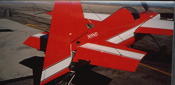

A boost tab relieves the load the pilot would feel in a pure mechanical control system.
Look at this one on an Edge 540..
It's hinged to the elevator, but attached rigidly to the stabilizer. As the elevator moves (in this case) down, the tab moves up. As it's located on the trailing edge, it possesses a good "hinge moment" for its size, and permits the pilot to deflect the control stick (and therefore the surface) further than he would be able to unassisted.

I use these quite frequently on large models, especially on elevator and rudder. They let a less powerful servo move a big surface. Just don't let the boost tab exceed 10% of the total moveable area or you will most probably get hunting or oscillation; the tab overpowers the servo.
