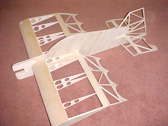

Ok guys. I have a plane you can figure out. I am at a lose so I need your help. I designed a profile, Everything is 0 and on center but, I have a full flying rudder. The plane has TONS of coupling in kife edge. Ail and ele. The only thing i can think of is the new rudder is messing it up. Any help would be great.

I think I am looking at two different airplanes, same design, different construction, however I think you answered your own question. The more symmetrical the airplane is top to bottom the less coupling there is. Assume the lateral area is the same top and bottom, the distribution of it is not even. The canopy is big and aft.
In the process of making the full flying rudder another thing happens. The top part is very effective in producing a couple about the airplane center line. There is nothing on the bottom to counter it.
Keep one thing in mind, for no coupling in knife edge you have to have everything symmetrical. If not then you need a bunch of effects that counter each other. The first is easier to obtain than the second (which is a wild guess in any science).
You would be better off with a total smaller area vertical tail, let some of it hang below the fuselage and just go with maybe a 50% or so movable rudder. Move the canopy futher forward and try to balance the upper and lower side areas.

So it was the rudder! So my next qestion is, what effect does the counter balance on the top of the rudder have on knife edge? I would think it would make it roll againt the rudder input but what do i know.

On the rudder. If you give left rudder with an airplane that has normal yaw roll coupling, similar to a shoulder wing airplane, it gives a left roll. The tip of the rudder gives a right aileron effect.
Your configuration is nearly neutral until you give rudder deflection. I would expect to not get any roll from the lower part of the rudder and right roll from the top of the rudder. Life is usually more complex than that so the above is just a educated (I hope) guess.

That is what i would think. Whe i put the plane in knife edge it will roll with rudder ( real bad too ) and also a ton of elevator is needed too.
