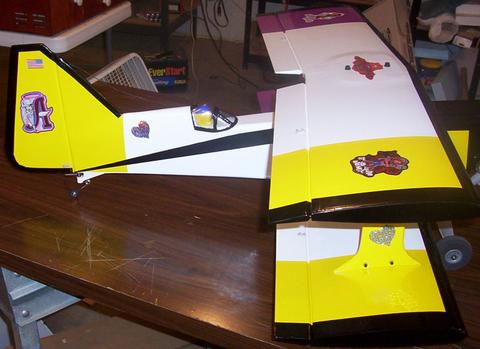

this might seem like a stupid question but is it possible to build a bi-flying wing, and has it being done before. i dont know a great deal about aerodynamics but get the feeling something like this would just tumble in the air

thats the kind of thing i meant, like a bipe with no tail maybe a bit more modern. would it work as a slope soar or would the top of one wing and the bottom of the other be in dirty air. can anyone think of any advantages or disadvantages to this setup

That would be a drag farm. It will work, but poorly.

It would definetly work best as a powered model. Any biplane format generates more drag for the area than the same area monoplane.

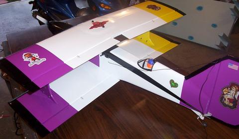

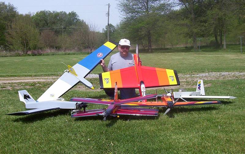

I don't know about electrics, but there are glow powered flying wing bipes. Here are a couple by Claude Vest in Indiana. All he flies are flying wings.
