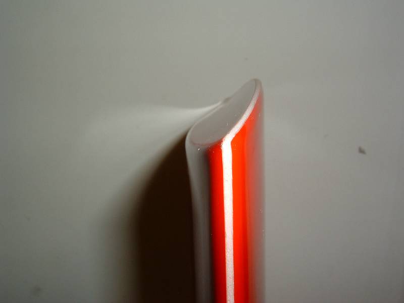

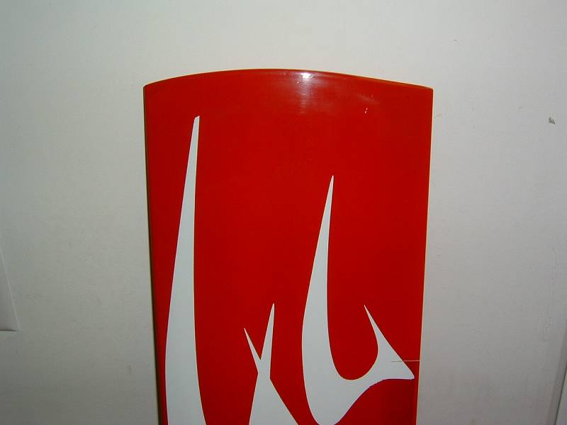

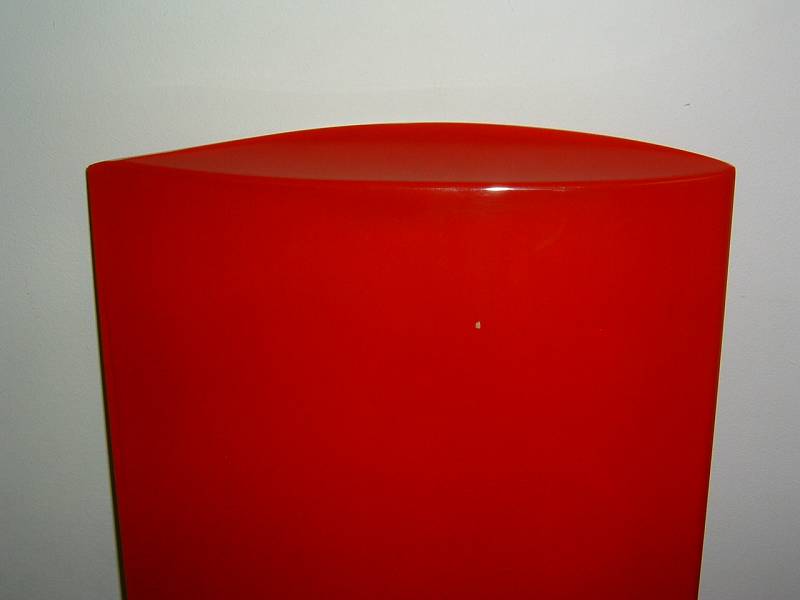

Michael thanks for answering on my post.
The all red wing tip #3 is the one that I designed using Hoerner and adding concave curve to the tip. Saw a picture of a Reno Mustang # 69 using this method.
The though behind this shape is, air flow is diverted for less educed drag in high speed turns, helps hold a knife edge from pylon one to two and from pylon three back to one, also acts as wash out to help in slow speed landings.
Also thanks for listing my R140 Quickee 500 airfoil on UIUC airfoil data site. I try to read every thing you publish.
Pictures are top front bottom and back of wing tip.

Randy,
Nice work on your wingtips!
I think your on the right track, at your level of competition even the smallest enhancement will help your overall performance. While I do not know the rules involved in your competition, I enjoy the exchange of ideas regarding aerodynamics, as well as trying to maximize the planes performance.
#32
He can not taper or go thinner with the airfoil.
The rules are pretty clear.
48" constand chord, minimum 1 3/16" thick at the high point.
Maximum wing length 52", minimum 500 square inches.
To me, I've always thought that the optimum tip would be 52" at the trailing edge and 48 " at the LE and whatever chord width it takes to give you 500 squares. Then taper the tip as sharp as possible outside of the 48".
Hoerner wing tips provide the largest effective span for a given geometric span or a given wing weight.
Edited for spelling error.

My favorite approach to carving tips is the taper the sharp edge to the camber line of the tip airfoil. There's really no proof that this kind of sharp tip is any better than another type of sharp tip. However, I do think the merits of THE Hoerner tip (drooped down) are iffy relative to any other (I agree w/ what HighPlains wrote above). I've not seen any specific data on Hoerner tips. I had one plane that had interchangeable tips - sharp, round, and squared off. What I found was that the squared off and sharp tips produced more max lift (I could pull tighter). This is pretty consistent w/ what Hoerner shows in his Fig 10 - more max lift. The lower drag part was not something I could confirm by flying feel. So I think your "sort-of" sqaured-off tips are going to behave pretty much like squared-off tips proper and also a sharp edge tip.
Michael
