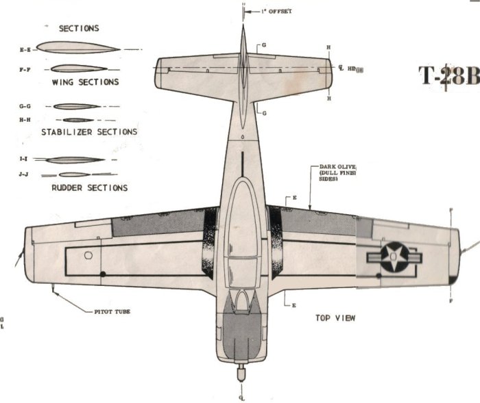

I didn't read probligo's link material but you may be interested to know that full sized prop planes often have some offset built into the vertical tail just for this reason.
It's been a while since I looked at this stuff so I can't tell you which direction the tail is offset but I believe it was a little right.
