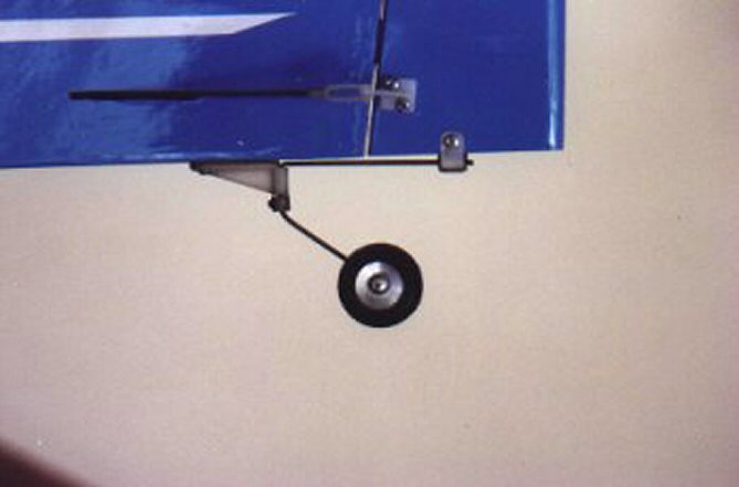

An easy way to de-sensitize the tailwheel is shown in the photo. This is a 40 size airplane and the pivot point of the tailwheel bracket is 1 inch fwd of the rudder hinge line and the rudder attach point of the tiller arm is 1 inch aft of the rudder hingeline; this ratio allows the tailwheel to deflect 1/2 the number of degrees that the rudder deflects. The steering is compromized in that you now have a larger turning radius, but still practical.
The key to a gradual increase of throttle to attain a scale like takeoff lies in Ben's reply above of holding up elevator to keep the tailwheel in contact with the ground until you have aerodynamic control with the rudder.

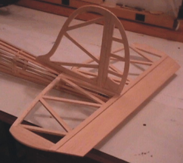

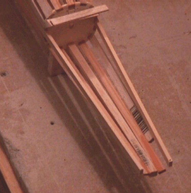

I'm wondering what the best way is to fix a tailwheel to the fuse that I'm building- fuse is formers and stringers, but the rudder doesn't extend below the elevator- (I'm hoping to post a pic tonight, but I've got a slow connection at home- if it doesn't work, will post in the morning on the good 'ol T1 at work-)
The options I'm considering are- 1) castoring tailwheel; 2) tailskid; 3)different tailfeathers
Opinions are appreciated-

the plane is basically an LT-40-

I'm aware that the LT-25 has a pull-pull tailwheel, but I'm not sure how it's done- is the same servo used for the rudder along with the pull-pull tailwheel?

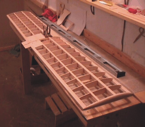

pic of wings, just for grins-
thanks, and cheers-

imo i would use a castoring tailwheel mounted on the former, with enough rudder throw, they work great, and even in x-winds my castoring tailwheel works better than when my tiger was tri gear, probably partially due to the nosewheel being slightly sloppy

I probably should have posted this in a different forum, but I thought that since the tailwheel issue was here, what the heck... anybody have ideas about a pull-pull set-up for this? Never done it, but I assume that the rudder servo somehow drives the pull-pull for the tailwheel as well?
