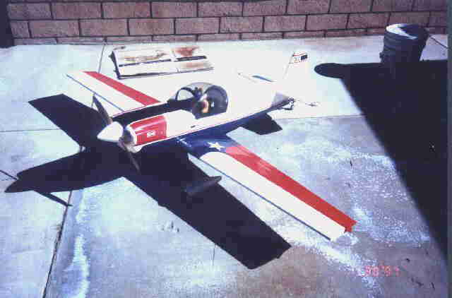

I had a lot of fun with this one.. 1/4 scale Byron, 35cc gas motor.
Vanished in a foam snowstorm one day.... (sob!)

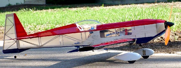

I have a 1/8 scale Extra 230 that will be ready to sell in the next few months. Here is a pic of it. The thrust line is dead center of the wing on it so that should be nice for what some of you are looking for.
