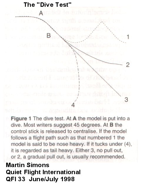

You may want to try using dive test method to set the balance like the glider guys do. Perform the testing at idle so it's the decalage and balance setup rather than the thrust alignment that you're testing.
Do a google.com on "glider dive test" and you'll get lots of sites that explain it in differenty ways.

With any model the first thing to get right is the CG. First, and easiest, check for this, asuming that the model is not excessive twitchy on elevator input, whihc indicates a CG too far\back, is to climb to height, throttle right back, and put the model into a vertical dive. As soon as the vertical down line is established return the elevator to neutral and observe. For a general sports aerobat you are looking for a straight dive of around 200 feet before the model starts to gently pull out of the dive. A rapid pull out indicates either a too forward CG or excessive difference in the rigging angles of thewing and tail (too much positive on the wing or negative on the tail - same effect). A model which starts to tuck under - going past the vertical - has the CG too far abck. Adjust accordingly.
Once the CG is demonstrably in the ball park, then is the time to start playing around with the thrust line.

Mike a plane that will diverge downward can show that property safer when it's not plummeting.
If such a plane is permitted to get too fast, it can become uncontrollable/unrecoverable. Any incipient tuck is more easily seen in a moderate dive, and stopped before it gets too far.
I've had a glider that was unrecoverable due to tuck from a moderate dive. 3 times!
Last time too much damage to bother with.
I look for just a bit of tuck on some fast aerobatic slopers.. I use it as a speed limit. The recovery can place a severe stress on the wings when a plane tucks.
Otherwise a slight amount of nose-up from the moderate dive is what I look for.

Here's Martin Simon's graphic of the dive test.
BTW, he's doesn't recommend doing it on something slippery like a fast glider which can easily accelerate to "tuck" speed and structural collapse.
