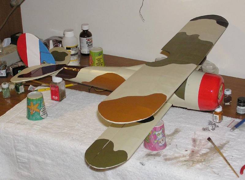

Hi all,
Bought an ARF bipe, but the location of the CG just looks wrong (based on several years worth of rc flying.)
Any way to figure out the cg and double check their figure?

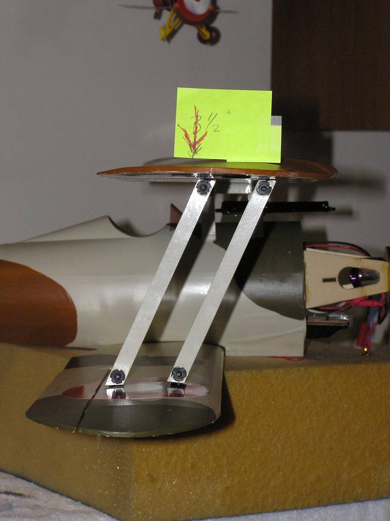

Ok gang, have a look at these numbers and see if they make sense:
Upper wing: 5 3/8β chord
Lower wing: 4 ΒΌβ chord
Overlap: 1 Β½β
Effective span: 6 7/8β
25% of 6 7/8= 1.71β should be the actual CG.
Mfg lists cg as being 3 Β½β from LE of upper wing.
Thoughts?
TIA,
Steve
If the wings are not swept back and both wings the same span, I'd go with the 1.7 to 2 inch back point. If the wings are swept then you have to find the mean aerodynamic chord and go from there.

Nope, both are straight wings so it's sounding more and more like the 1.7-2.0" CG is the way to go.

Couple of thoughts, having scratch built a bipe or two
First, hard to tell from the picture, but it LOOKS like you're measuring that 3.5" from out near the wing tip. Unless specified otherwise, it's fairly common to measure the CG from the CENTER of the top wing on most bipes. Not saying either way is 'right or wrong", just common, and possibly worth checking. Looks, by rough guess, that the 3.5" back in the center would be close to your 1.7" figure out near the tip.
Second, when all else fails, aside from it being time to get a new all else, I've had consistent good luck with bipes using the top wing's spar as a starting CG point. Again, this is at the center of the wing.
And, finally, in general, any CG that falls between the front and rear cabane strut attach points (on a bipe so equipped) will usually result in at least a flyable machine. I've never come across one whose "safe and comfy" CG was outside of that range, but obviously, that's a fairly subjective judgment.

Like you suggested, I measure at the center of the wing root. I just put a sticky note on the wingtip to show the CG in crossection.

Looking at it, I'd be willing to risk MY plane on balancing that bird on the top wing spar, and heading off to fly. Might not be ideal, but I'd be comfortable that it'd be flyable.

The picture tells a 1000 words and those words are saying "THEY ARE NUTS! ! !". You're right to question that location. I don't know where they got that number but it would be a disaster looking for a place close by to happen at takeoff time. I'd go with 1.7 to 1.75 from the upper leading edge and see how it works out for the test flight. That would be a safe starting point for sure.

use that "fat chord" as basis for the cg location
