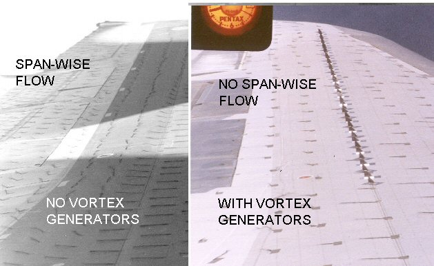

Posts: 5,211
From: Palmdale, CA
Default Airliner finlets???
There's a surprising amount of span-wise flow even at high speeds occuring behind the local shock position.
We experimented with generators on the Tristar. Typical flow patterns looked like these..
Didn't install them ultimately. A combination of NIH and looks bad..
Old 05-13-2003 | 05:57 PM

Old 05-13-2003 | 07:13 PM
BMatthews's Avatar
Posts: 12,432
Received 28 Likes on 24 Posts
From: Chilliwack, BC, CANADA
That's an amazing pic Paul. Interesting that the tufts in the first shot are flowing OUTWARD. I would guess into a localized separation bubble that was eliminated by the vortex gen's.
And what's NIH mean?
very interstesting pic, I would be intersted to know at what EAS it has been taken
Old 05-13-2003 | 09:57 PM
Joined: Jun 2002
Posts: 5,211
From: Palmdale, CA
The b/w was taken at a 1.9 w/delta... probably about .85 Mach.

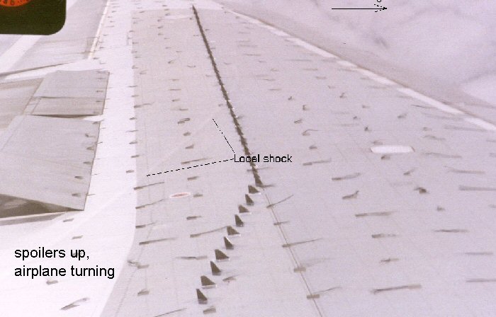

Here's another odd one....
that's what I tought, what we saw is a sonic shock wave
