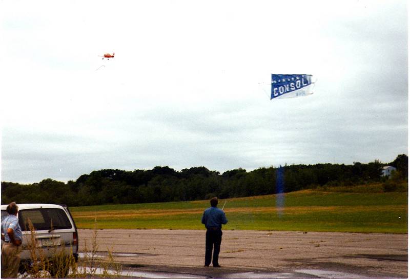

Assuming we use a large Cub as the tow plane...should the towed banner/flag...etc...be connected to the airframe at or near the CG, or at the tail?
What are the pros and cons.

At the CG will only add the drag to the models performance (or is that subtract )
Adding that drag to the tail will dampen your control throws, think of a tail on a kite.
Adding at the CofG is the way to go. We have used a dowel passed through the airframe with good success.

I have towed banners for since the 60's and always hook yp to tail wheel. I make banner out of lace material and cut letter out of Felt cloth, I use a Dowel in the front of the bannner with some lead on bottom of dowel so banner will tow straight. The Navy used this system to tow target banners for other plane to shoot at them. Four different plane would use this banner for target practice, The plane bullets were dipped into different dye so they could see what plane had it the Target. I hope you can understand this BOB MOORE

Two guys in our club tow banners and both hook to the bottom of the plane near the CG. They're configured as Bob Moore recommends, made of mesh with fabric letters, a few dowel stiffeners and small weights crimped along the bottom edge.
They take off with the banner furled, unroll it in flight and cut it loose to land.
Occasionally the banner comes out but doesn't unroll, just trails along at the end of the leader all rolled up, but usually a low pass to bump it on the ground will knock it open, which makes a better show!

I have towed signs and banners.
I hooked the towline to a release at the tail.
I found very few drawbacks to flight with the banner on.
Pitch was slow, but the plane turned fine. Rolls and inverted were also OK.
Plus side , all adverse yaw was eliminated by the drag of the banner.
I've towed with Aeromasters and Sportmasters and even a Falcon 56 all without problems.
