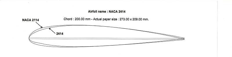

Other than a general confirmation of the type of airfoil, with no explanation as to what's different about it, I found this on a Bulgarian site..
http://www.aeronautica-fm.de/Page103...09f_blatt1.gif
I'd use a 2414 myself.
Looked in Profili.... presuming the "R" is some "revised" designator for an NACA 2114, and plotted a 2414 on top... I got this.
Not enough difference to be concerned about for model size.

DOH! I should never post anything airfoil related without checking my copy of Profili 2 first. There's a 12% thick 2R1 12 in there. It's a fairly normal looking airfoil that has a small up curve in the lower trailing edge indicating some reflex to the camber line. Being quite normal looking I'd say it would work quite well up to a moderate wing loading. And the reflex would reduce any pitch stability issues related to the rather small stabilizer.
If true scale isn't an issue the Selig 8036 would be a good choice given it's proven ability to handle higher wing loadings with grace.

I managed to scale the 2R1 X&Y numbers from profili & generated the correct %THK.
