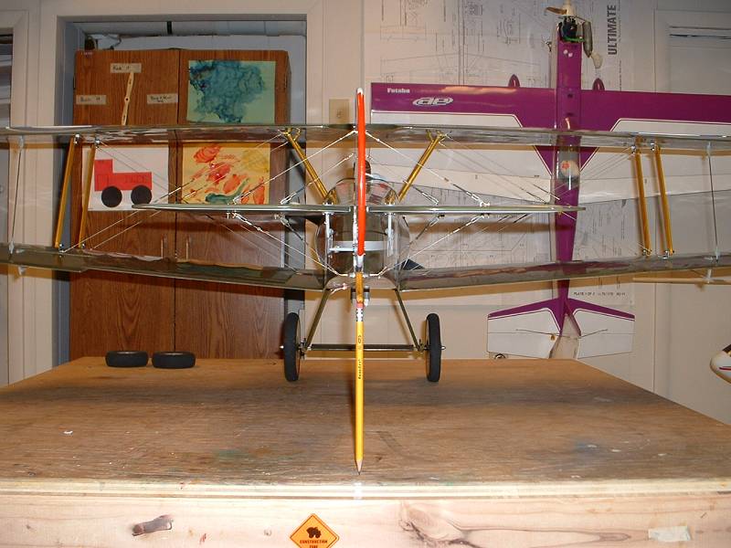

I have a just built sopwith camel from h9 that has a serious(no major) hook to the right on the ground. it also rolls right when it gets in the air.I had gone back and balanced the model laturaly. When building the model ,I change the way the motor fits to lay sideways with a pitts muffler.If my thrust line is off a little bit, would this have a major effect like this, or could the plane be nose heavy. Its a Royal handfull on the ground and I cant get it in the air ( or is this how the plane handles on the ground and I need to be more consistant with the rudder) >>>>>>>>confused

Got a picture of it from directly behind the tail?
Rolling in the air is a pretty common symptom of a rather common problem.

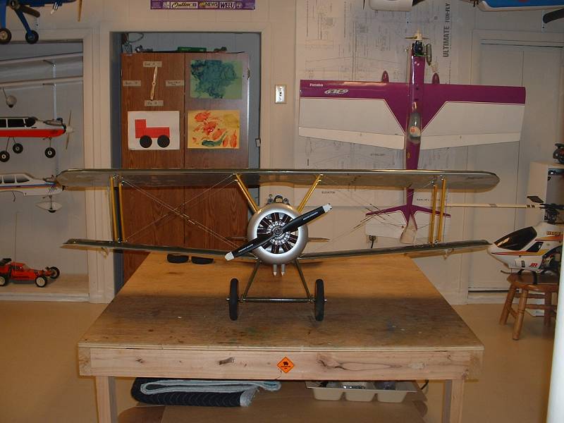

Got a picture of the wheels/gear from directly in front?

Here are some pictures...

Pretty good pictures.
I think I see one problem. Your shop is too neat. And it's also too large.
The rear view pictures were to see if any obvious warps were present. They aren't bad enough to show in rear picture. But rolling is really more often a warp or trim problem than lateral balance. Do you fly with anyone who's good at eyeballing for warps? From one of the front pictures, it looks like there is a chance the lower right wing has washout compared to the lower left wing. But it's hard to see for sure. When you look at the plane, push the ailerons into alignment with the wing. They make it hard to see a warp when they're not lined up.
Looking hard at the gear, there is a suggestion of both wheels aiming at bit to the right. As Bruce has already said, there are a lot of other things to eliminate first. But rigid gear on those "tall" suckers will accentuate misalignment. I usually take my models out in the driveway and "free roll" them to see how they do on a smooth, clean, level surface. That'll tell a lot about how the wheels alignment affects the takeoff roll. Keep in mind that it really doesn't play a big part after the prop has some purchase on the air and the plane's got a bit of speed.
It takes awhile to get good at seeing twists. But it does sound like you've got one to find.

Looking at the 3rd from left pic...It looks to me like the left aileron on the bottom wing is down?
That would cause a roll to the right...All the other ailerons look like they are lined up ok though.
That is exactly what I thought looking at the picture, the wings are not symetric in plane.
You can take his great rear photo load it into Photoshop and put up a ruler line. It becomes far more obvious then.

In the rear-view picture in post #6, only the lower right aileron look to be aligned with the trailing edge of the wing, the upper left aileron looks to be 1/8" down, the lower left aileron looks to be a 1/4" down, the upper right aileron appears to be 1/16" up and also warped as its trailing edge does not look parallel to the top of the wing. If these are the aileron positions that you last flew with, it is no wonder that it rolled right on you. Was the picture taken with the plane and radio turned on? If not, then you'll need to re-post a rear view picture. Also, the ailerons need to be perfectly aligned in order to help spot any wing warping so you might want to post a picture of the ailerons perfectly aligned to the wing in addition. The different throws of the upper and lower ailerons might not be a problem if the ailerons are more misaligned when they deflect upwards than they are when they deflect downwards. This situation would, for example, create more drag on the left wing in a left roll and help negate adverse yaw.
I've read somewhere in these forums that somebody had success with toe-out on their mains. I've, previously, always heard to add toe-in, but if you think about it, toe-out makes sense. For example, if you are taxiing along and add too much right rudder, the right wheel leaves the ground and the toe-out on the left wheel counters the excessive right input and steers the plane to the left. With toe-in, the plane's left wheel would have continued the right turning of the plane. Maybe even enough to cause a ground loop. It might be worth trying a couple of degrees of toe-out if you can't correct the problem of yaw stability on take-offs any other way.
