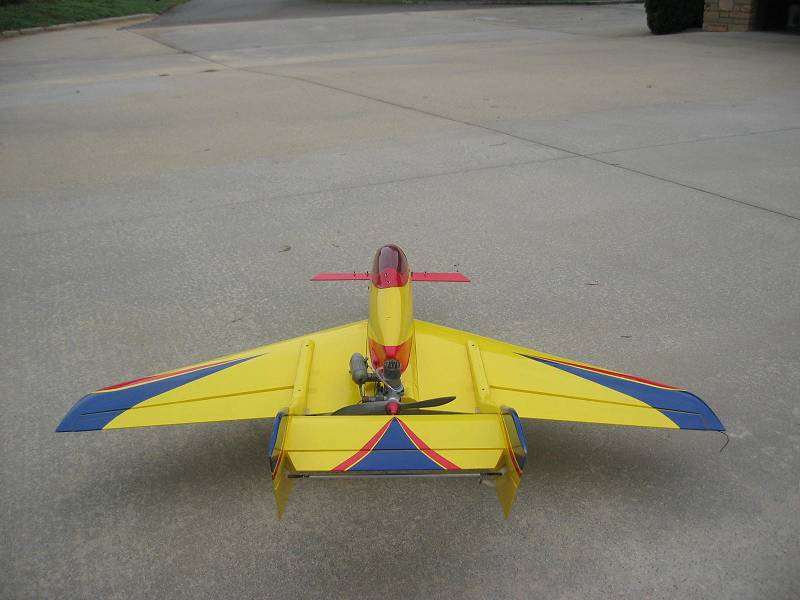

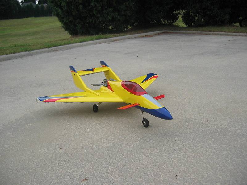

That particular engine runs backwards but without reversed crank. Note the position of the carb and front housing.
Bill
The airplane has a number of flights with and without canard. The engine is a .45, airplane weights 8 pounds and take off performance was marginal. The canard added noticeable take off drag. The airplane now has a .50 engine and still needs more reserve during take off. It also appears that dirty air off the wing reduces maximum rpm.
Bill

Yes standard prop mounted backwards. The two backwards .45’s that have been flown on the airplane appeared to be sensitive to heat. The .50 with pusher now being flown requires the use of a smaller pusher than tractor prop. Normally I would use a 10 x 8 or 10 x 7 tractor but a 10 x 6 pusher is required for the .50. A 10 x 7 pusher will simply not come up to speed reliably. I suspect a combination of heat and bad air from the wing. There is always the possibility that the APC pusher is not an exact reverse image of the tractor.
I didn’t change the CG but I also did not disconnect the elevator. Control was good while in the air. I damaged the airplane several times before collecting much canard data due to inadequate take off power. Take off seems to be ok now and the canard is off while I master the art of no bounce landing.
Bill
With your canard wing in place, do you readjust the CG as needed for a canard?
Bill
Hi BILLS
Is the plane you pictured the NitroModels Bobcat 50? The specs indicate the weight at 5.5# and your's is 8#. Why? I have always liked that Bobcat 50. Hard to believe it is a $99 ARF. Why so low a price?
The stated weight by NitroModels should not be believed. The finished weight of Bob Cats reported in forum starts about 7 1/2 # and goes up to about 10 #. The manufacturer probably never flew the model. Without engine and radio gear the stated weight would be approximately correct.
Bill
