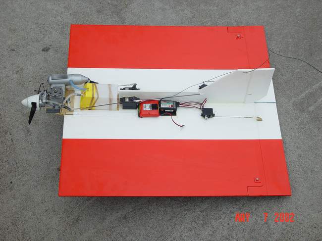

why is this thing stable in roll? it flies, and with enough control to fly circuits around the yard, I bet a roll or loop is not out of the question.
[link=http://www.rcuniverse.com/forum/m_8222254/tm.htm]http://www.rcuniverse.com/forum/m_8222254/tm.htm[/link]
I am completely baffled, my only guess is the chines have some dihedral effect. but the center of mass is way above the center of lift (the sled)..

From the video it looks like your craft flies a lot like a "pizza box flyer". PBFs are not too different than flying lawn mowers. My PBF was very stable at high angles of attacks (45+ degrees) too and roll-stable at all AoAs. Although it had elevons, I found that I could steer it around quite well with rudder and elevator input only because of this roll stability. In other words, aileron input wasn't necessary to fly it around. Aileron input was only necessary for performing certain aerobatics.
I don't have any video of my PBF, but here are a couple of pictures.
