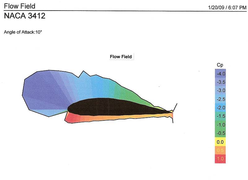

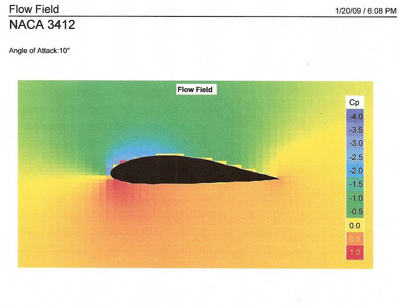

My question one is I have attached the images I got from Javafoil below. The airfoil I made is the one that is on the airplane kit I am building. Please guys can you tell me whereabouts does the boundary layer separate? Please just mark the spot on one of the attached images. I am guessing that the separation occurs where the blue pressure colour suddenly turns suddenly green on the flow field picture for the Cp, pressure coefficient. Also, when the more negative the Cp is, the less the pressure is there right? And the mroe positive it is, the stronger the pressure is? Am I right?
It was Ludwig Prandtl who explained why this is so: Because the velocity in the boundary layer decreases towards the surface of the airfoil, the kinetic energy of the fluid inside the boundary layer is less than that at the outer edge of the boundary layer. This means that while the pressure rise in the outer flow may be quite significant, the fluid particles inside the boundary layer may not be able to overcome even a small adverse pressure gradient causing fluid particles near the surface to stop and maybe even reversing the flow causing a recirculating flow region characteristic of separated flows.
As for your lift equation questions the formula L=0.5*rho'v^2*S*Cl is commonly used. What lift coefficient a certain airfoil can produce at a certain angle of attack has to be determined from polar curves and/or CFD calculations. There is no simple formula for this, especially not at high angle of attacks. At small angle of attacks the Cl vs. alpha curve has a slope of 2*pi for 2d airfoils. For finite span wings this value should be corrected for aspect ratio (and other factors). A commonly used correction for aspect ratio is 2pi*AR/(1.25+AR). This is often accurate enough for model aircraft purposes.

I understand all you said except how have you pointed out that in fig. 1 (i.e. the graph) the separation ocurs at 30% of the way back from the LE? I would this that it is at 0.2 (i.e. 20%) because that is where the pressure rises. Can you reply on this please? thanks.

suspicious to me. It occurs before the thickest point on the wing, which
doesn't seem right, and it is very abrupt. I am viewing that as a likely
spurious value. If JavaFoil gives you the option to run a more precise analysis,
I would be tempted to do that.
Boundary layer separation, if it occurs, will tend to occur a short distance
after the negative pressure peak.

A short comment: What you should look for is the chordwise position where the slope of the pressure distribution becomes negative. This is where the pressure gradient becomes adverse. What you consider to be a pressure rise at slightly less than 20% is actually a pressure decrease (look at the sign of Cp).
