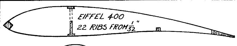

Working on yet another old-timer.
On construction notes is that original used an Eiffel 400 airfoil. I don't got that on any system.
Can someone give me the coordinates so that I can then reproduce it?

A picture of it for what it is worth.

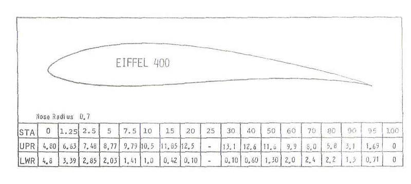

I received the indicated information via another web forum yesterday. Fits my needs.
