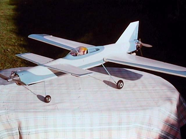

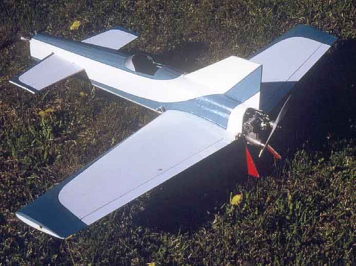

Once upon time I tried cmpetition pattern designs made as pushers
and dual boom and rudders
It al worked very well BUT look ed awful in flight during rolls
also maneuvers designed ar ound tractor dsigns di not work very well -
The rudder needed to be in the accelerated airstream.
very stable -no torque reaction as th prop was ON the cg. (swept wings with proplocated at the root. which was also CG)
a very interesting project at the time

That was not aproblem on my pattern setup maybe I will pull out the old pics and copy digitally
I had very low wing loading soa very low difference in pressures.
The pure mechanics tho of pusher is typically a bag of compromise after compromise. The Rutan stuff was darn good
BUT if you flat spun those setups be preparred to use the parachute.
Like the old Ercoupe
"you can't spin em " However if you happen to spin one - get out.

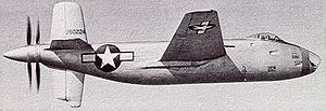

2. Learfan 2100 was more economical and faster than Citation I Bizjet
3. Mixmaster did the same as B-17 but with 2 engines and was 100 mph faster
4. Edson Fessenden Gallaudet flew 130 mph in 1912 with a pusher.
