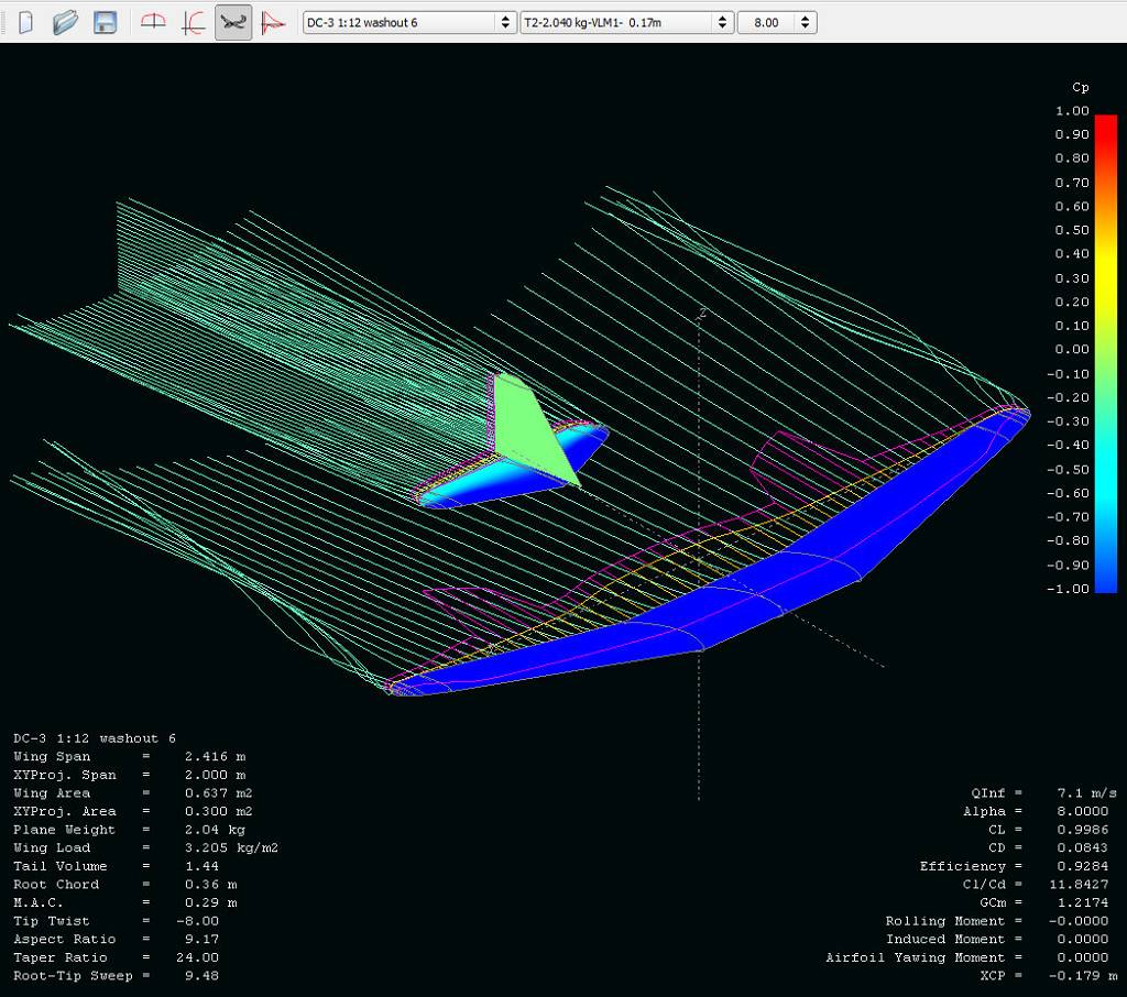

If anybody cares, here's the result of my sunday afternoon relaxation, trying the [link=http://xflr5.sourceforge.net/xflr5.htm]QFLR5[/link] program mentioned in [link=http://www.rcuniverse.com/forum/fb.asp?m=9070389]the other thread[/link]:
Only wing and empennage are rendered because I was interested in the tip stall problem. Fuse and nacelles would obstruct the view of the wing airflow and have been omitted. The wing center section has NACA 2215 airfoil, the outer wing panels are tapered to 2206, just like the original. Only the elliptical wing tips have washout but not the swept panels with the ailerons, just to elaborate the problem. Size of the model is 1:12 (95" wing span), weight 4.5 lbs, c/g 6.9" behind center leading edge.
With all due caution, the program shows the general problem of the DC-3 wing, even if not exactly.
The first picture shows the case aoa=6 degrees, what is twice the incidence angle. So the fuselage is not exactly in flight direction. Speed is 22 mph, the lift coefficient 0.66. That is the cruise flight tested in the simulator. The wing's upper surface is blue indicating low pressure. The orange grid behind the wing indicates induced drag, the pink grid behind wing and tail indicates viscous drag. The red line on the wing from tip to tip shows the point of transition from laminar to turbulent flow. It's slightly aft of the maximum thickness, as normal. The green lines behind the wing are streamlines showing the decent tip vortices.
Now compare the second picture, aoa=8 degrees. Bigger induced drag, very noticeable tip vortices, and a more forward transition line. Most interesting is that the transition line comes close to the leading edge outboards near the wing tips. Only 1 or 2 degrees more aoa and the transition reaches the leading edge and stall begins. (At least that's my interpretation.) That's what happens also in the simulator. So the wing's lift coefficient seems to be limited to 0.85 or 0.9 due to early tip stall.
Now the tapered and swept wing panels have 3 degrees washout. Still the elliptical wing tips have additional washout, like before. Of course, the tip vortices are smaller at aoa=6 degrees and the laminar/turbulent transition is more aft near the wing tips. Lift coefficient is only 0.60, as is due.
Gain is 2 degrees more aoa (10 degrees) and a 0.97 or 1.0 lift coefficient - not too bad. What the pictures don't show is that the stall is now more abrupt and severe. The complete outer wing stalls now at once while the stall progressed from the tips inboards when the wing had no washout.
Neat! (Sorry for the metric units.)

Have to correct: It's not the elliptical wing tips which stall first, it's the tapered and swept wing panels. To make it blatantly obvious, here's how it looks if this panel has even 6 degrees washout, progressively from the square center panel to the elliptical wingtips. At the same time the airfoil is tapered from NACA 2215 to 2206, as before.
Nearly no lift at the wing tips (look at the orange grid for induced drag) and laminar flow (the red transition line) for aoa=6. One more degree of aoa before stall begins: aoa=11. Very little lift at the wing tips and mostly laminar flow. But strange things happen, there's much viscous drag (the pink grid) in the middle of the tapered wing panels. Like before, the transition line comes close to the leading edge near the wing tips.
At one more degree aoa (12) the tapered wing panel stalls except a small outer part. Again one more degree aoa (13) lets the whole panel stall, and even one more (14) also the wing tips. The square center section is still unaffected. Only at aoa=17 the center panel stalls all at once.

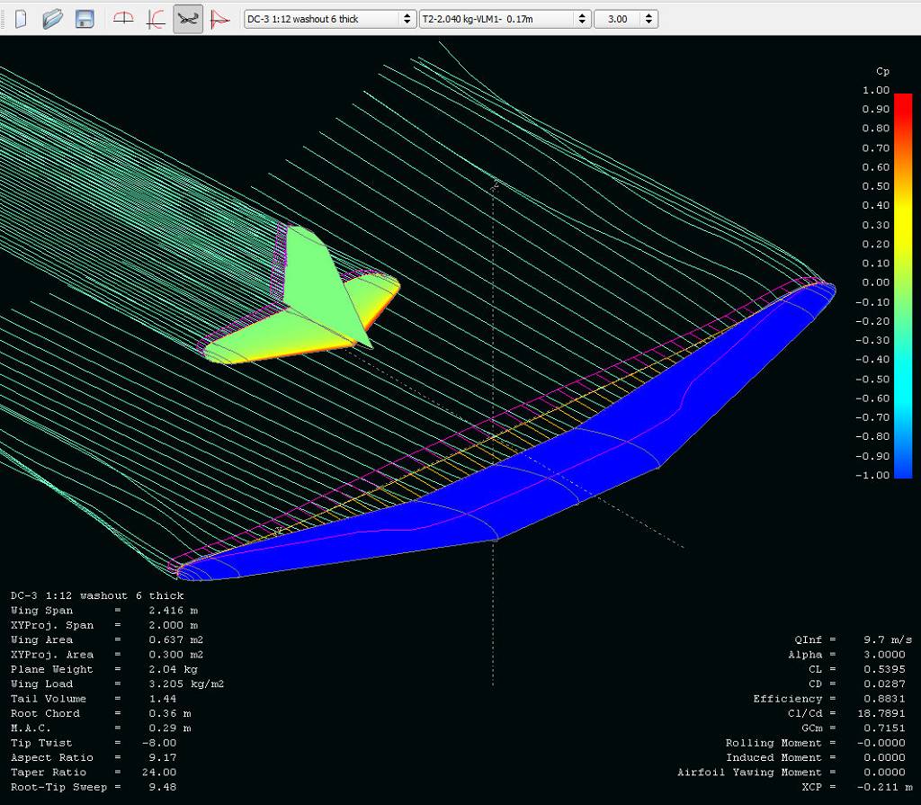

Well, using the 2215 airfoil for the whole tapered wing panel does change something but doesn't really make things better.
In both cases, 3 and 6 degrees washout, there's now a real tip stall: the elliptical wing tips stall first. The stall is not abrupt but smooth and progresses slowly - just in the wrong direction. The stall starts at the tips (aoa=12) and progresses inwards until it reaches the root (aoa=17). Duh.
I think it's simply the high taper that makes for a "bottleneck" in the midlle of the tapered wing panel. There the chord is too small while it is enough at both ends, so to speak. Seems the designer knew what he was doing.

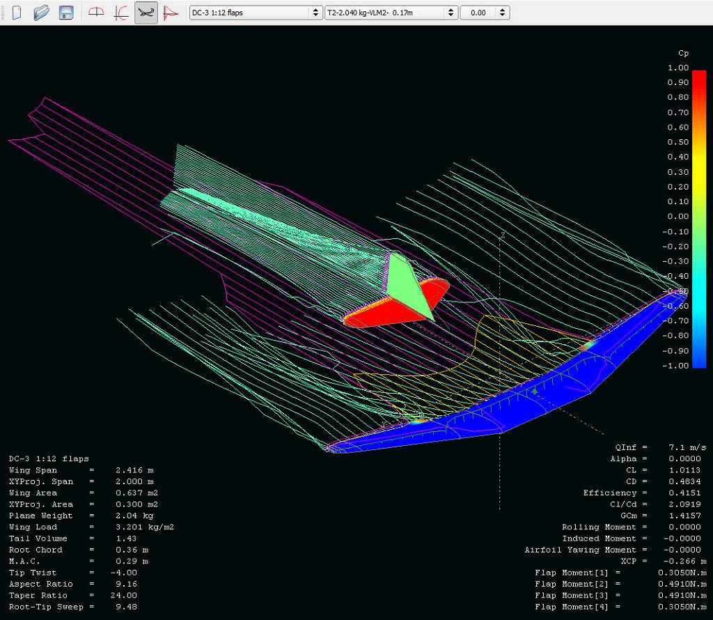

OK, here it is with flaps. Original configuration with 2215/2206 without washout. There are no split flaps in the program, only plain flaps, here set to 45 degrees deflection. The classic VLM method didn't work, so it's Quads. Don't know if the results are comparable now, but they look reasonable.
It's as expected: smooth stall beginning at root and progressing to the tips, over a span of 4 degrees of aoa. But: These are rather small aoas. First picture is for aoa=3, meaning the fuselage is level. The second picture is for aoa=6, just before stall, which begins at aoa=7 and is complete at aoa=10. That's not bad at all. It confirms that the tip-stall problem vanished and the plane stays controllable as well as that no three-point landing is possible.
The pictures look rather messy, showing some strange (?) things. There seems to be a negative induced drag where the ailerons are. Much uneven viscous drag behind the flaps. Strong vortices at the flap-aileron break. Doesn't look wrong, though.
The aoas look similar in the simulator, but the stall seems to be somewhat indifferent and looks like a tip stall. The model is controllable though, like a 3D pattern model which can do no steady harrier. I wonder which simplified stall model the simulator uses to get this behavior. Oh well.
An afterthought: The rear view with streamlines clearly shows any vortices. The "clean" wing at aoa=8 also looks clean, no vortices except at the tips. The "dirty" configuration also looks dirty with many vortices, especially of course at the flaps-aileron break. But the whole outer wing panels with the ailerons have small vortices as well. Maybe that's why the airplane seems so wavery, not knowing whether to fly left or right. Over-interpretation?
